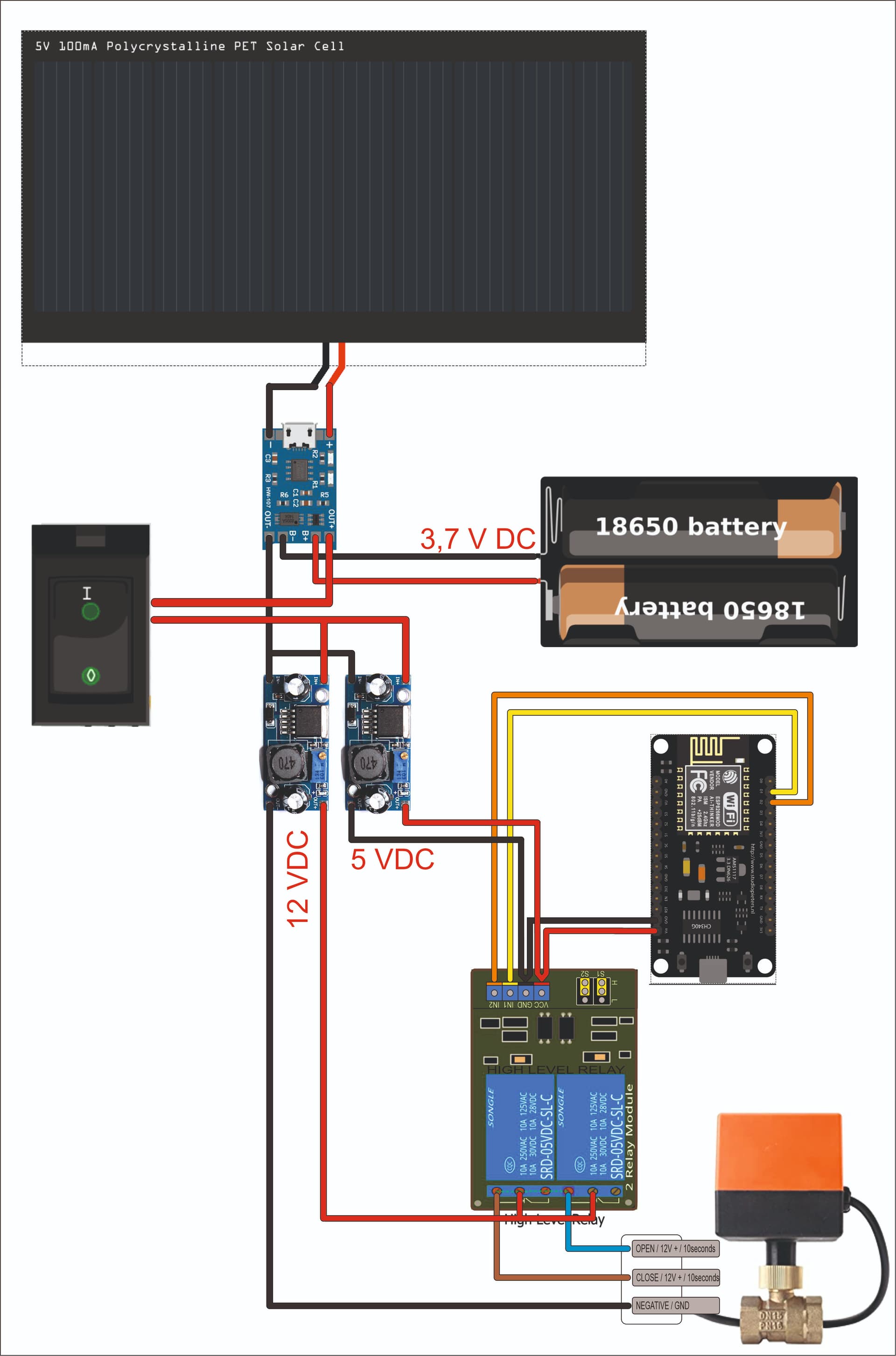

Hello, I am doing a project to open and close a 12v electric valve once a day, to fill a tank, and that it feeds a drip irrigation system. But I would like someone to help me with the code, because the one I have created is very rudimentary, and I don't know if I'm going to have problems programming it to open once a day, because it takes a lot of milliseconds. what could i do to schedule with days?

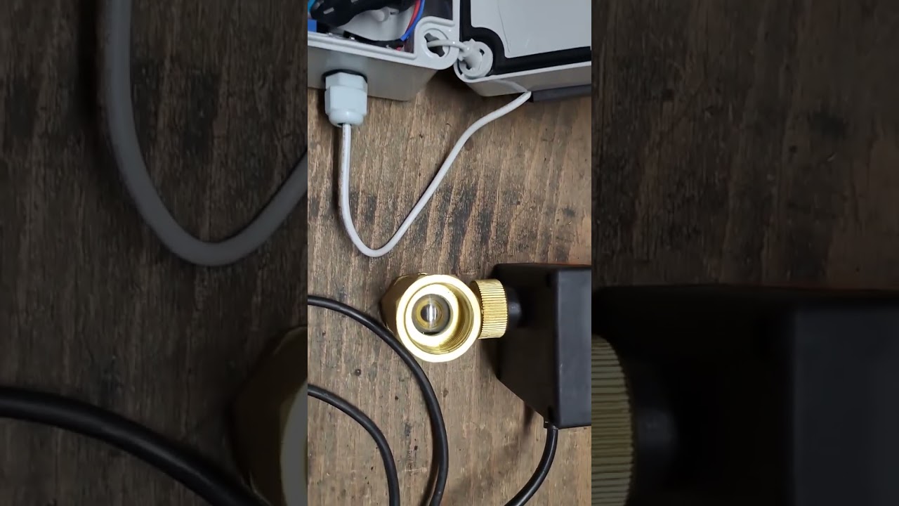

I attached a video uploaded to YouTube of how the project is still going. And what do I want to do? And I leave my code, which I repeat, is very rudimentary. I activate the relays in a high state so that I don't use up the batteries. I don't know if it's the most productive.

Can you post a link to the specific relay board that you have? As long as the relay is not activated I doubt the control signal will be an appreciable amount of power, at least not compared to the power needed for an ESP8266 to operate continuously.
Are you intending to use the WiFi capabilities of the ESP8266? If not, then a Pro Mini with an RTC would be a better choice for low power consumption, the processor could be put into sleep mode and woken up by the alarm on the RTC. For extremely low power consumption, there are latching valves made for irrigation systems that only require a short pulse of power to operate.

The times that I have set are the minimum necessary to record the short video and to see a first functional test. I am aware that for a section of time, it lasts a single day, I have to multiply the milliseconds, but this has been the reason for uploading my project to the forum, and asking for help. I want to know if there is any programming formula for whole days, simpler than not using milliseconds for one day. The motorized valve works with a small 12 V dc motor, there are three cables, one is ground, another is +12 V dc for opening, and the third cable is +12 dc for closing, and both closing and opening, the The motor takes about 10 seconds to complete, to make sure I have set 15 seconds of 12Vdc power for both opening and closing. I'll post a schematic of the circuit I'm building later. The first thing I have set in the program is, because it activated the two relays at the same time, with the possibility that the control pcb inside the motorized valve might burn. To get 12VDC from 18650 batteries, I have put a step-up booster power supply pcb, which works perfectly for me at the moment. Both the valve and the waterproof box with the solar panel and the whole set, I want to have it in the middle of the field in a place where the electric current does not reach. It is what makes it interesting, and above all, very cheap. I know that there are programmers with tubes included with batteries, but I think that the programming possibilities of working with ESP8266 are almost infinite, and I am entering this world of programming, and it is my first project in this regard.

You could make it impossible to power the opening and closing connections simultaneously by rearranging the relays. Wire the 1st relay with 12V to COM, then connect NO of this relay to COM of the 2nd relay. The motor wires for OPENING and CLOSING would be wired to the NC and NO contacts of the 2nd relay. To run the motor, first use the 2nd relay to select either the OPENING or CLOSING connection, then activate the 1st relay to provide the power.
