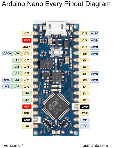

Check your wiring closely for the serial pins. It looks like tx and RX are switched in location from the nano to the Uno. It’s still RX 0 and tx 1 however.

@studiogamma I checked the pins indeed. The strange thing is that it sometimes output information through.
You don't need SoftwareSerial. Pins 0 and 1 are Serial1 on a Nano Every.

@jremington the AD9850 is the module I'm using to driven my speedometer.
@sterretje to clarify: I just delete the softwareserial library and the softwareserial line?
Can you adjust the code what might have to work?
I think this is the code modified for the Nano Every. gps module Tx to Every Rx and gps module Tx to Every Tx.

@cattledog @sterretje heroes!
