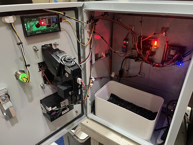

Coin Acceptor abruptly stops interrupting
Hello everyone! I'd like to ask for help with my coin acceptor. So my coin acceptor is wired to D2, every time it powers up, it accepts coins and the blue LED on my ESP8266 pulses depending on how much was inserted (i.e. 5 peso coin -> 5 pulses), but for some reason, at times it just stops counting/crediting. For example, I put 10 pesos, it should count to 10, but stops at 5 or 6 randomly. Then when I insert another coin, it accepts it, but it no longer counts the credit. When I restart the system, it returns to normal, but after some time, it stops abruptly again. Here's my entire code for the system:

Sorry for the long code and the question. Thank you for your responses!
You might edit your code and remove ssid + password string (or are these dummies)
Some quick points
bool firstCoinOn = true;
should be volatile
void IRAM_ATTR btnInterrupt()
should be shorter, clearing an LCD within an interrupt routine takes too much time.
Just set a flag to clear the display and handle that in loop()
Can you post an annotated schematic? Also is there any magnetic devices involved such as solenoids, motors, etc? If so post a picture of your layout as you are having the problems.

Hello Rob, I completely removed the LCD.clear in button interrupt, and the interrupts now only contain the following code:

Hello gilshutz, I'm currently working on the annotated schematic. Will post it here when its ready. Thank you!
For trouble shooting, I'd consider switching a led on in the pulse counter interrupt service routine and switching it off again after a short time in the loop(). This would identify problems with the coin counter. Something like this:

@billygarcia you were given good advice by @robtillaart. In this case it did not fix the problem, but it might have done and the changes should be kept anyway. The advice was given from a high level of experience and expertise, and for free, and you should not dismiss it in a disrespectful way as you did.
Thanks for this feedback, the interrupt routines are now short and therefor far more robust, and can be removed from the list of possible causes. Apparently it did not solve the problem, so further analysis / debugging is needed. Be aware that remote debugging such problems is nearly always an iterative process, so it might takes days (or weeks or longer).

Found another point of attention
 //Credit counter
  if (impulseCount == coinPulses[coinType]) {
The variable coinType is initialized to zero and never updated as far as I can tell.
Find below a minimal sketch that only looks at the amount of pulses you get from the CA.
It prints the pulses per coin on one line (you might add timestamps).
You need to configure the separatorTime to match the time between two coins.
Can you run this sketch and see if you get all pulses per coin.

Hello, I'm back! Sorry for the long wait, but here's the wiring diagram of my system:
I have a custom board (JCB Juanfi Custom Board) ordered online:
https://tinyurl.com/6dvhuh3n
Here's it's PIN allocation:
Here's a picture of the actual wiring:
And the video of it abruptly stopping from reading coin pulses:
Hope these help us guys! And, again thank you for your responses :slight_smile:
Why do I see lots of junk wire splices where there are color changes? Use ONE wire directly between connection points and one color for power, one color for ground and various colors for various signals. One color per signal.
Hello everyone, I'm glad to let you know that my coin acceptor now works flawlessly :slight_smile: . I have made changes to the wiring as suggested by @Paul_B , and the code shared by @robtillaart. Thank you very much for your help!
And looks SO much neater and easier to debug when necessary!
