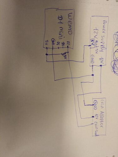

I've used a 10k pull up resistor connected to the coin acceptor signal pin at 5 more volts.
Please explain what you mean by this. A circuit diagram showing how you have wired things would be helpful. A photograph of a hand drawn diagram would be good enough
What voltage does the coin acceptor output when a coin is inserted ?
I don't know.
I was using an interrupt function like this in the code on the arduino nano and it was working fine, except that in wemos I cannot define the interruption so we will atrophy.
I don't know how I have to define the function of the interrupt
What do you mean by this ?
I think it has to do with the attachInterrupt interruption function (D2, coinISR, RISING) that we have atrophy. without this function it does not give that error on the serial monitor, there must be something wrong with the function
What error do you get when you use attachInterrupt() on the Wemos ?
upload the code to wemos, but then this error appears when viewing in the arduino program via the serial monitor
the error is as follows:

I already solved this error problem,
I had chosen the generic esp8266 card manager, switched to wemos d1 mini and took the code #define D2 19 and it worked.
