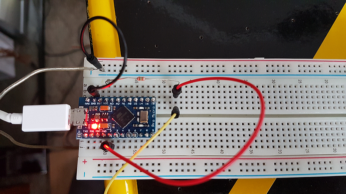

I think it's time for you to draw a schematic of how your all this connected together.
Paul
Well here's the sketch I have to start out with. Eventually I want to replace LED with a motor.
Waiting for the schematic.
Paul
The picture show the best of my ability for schematic.
ART50317:
There's an attachment. a picture.
Why do you have the Arduino reset pin pulled high to 12 volts?
Paul
It's not I met to draw on the vcc.
