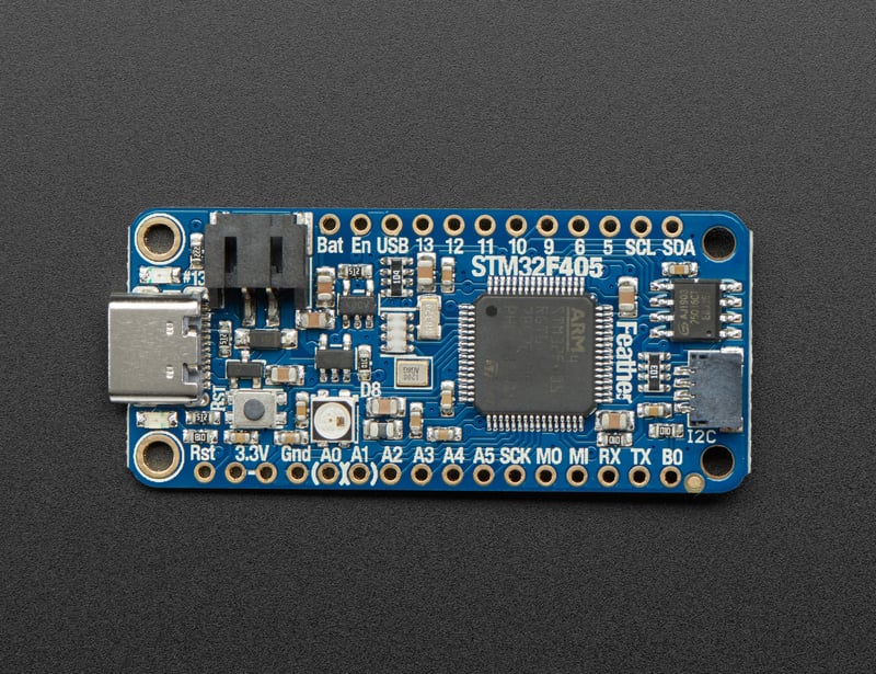

Combining 2 software serials
Hello, I have 2 software serial devices, a gps and pm sensor, I ma only seeing the reading from the pm sensor and I think it's because the serial ports are interfering. I looked at the Arduino documentation but I don't know how to append the sample code to my code. I have attached my code below if anyone who know how you would go about this please let me know. Thanks!

Which Arduino board are you using?
Only one instance of Software Serial can be listening at any time. You have to perform the switch in code. Your first stop should always be to check the library docs!
I did check this but I don't see where to implement what in my code
Which board are you using? I see a reference to STM32SD and what appears to be code for an SD card.
I am using the STMF405 Feather board. and yes that is code for the sd card data logging
would changing the baud rate for one of them fix it?
Not familiar with that board, but it looks like it has multiple hardware serial ports.
So can I wire one to software serial and one to hardware serial and run it at the same time?
Lookup the pinout of the STMF405 Feather board
You will find there on wich IO-pins you can access the second and the third hardware-UART.
best regards Stefan
even when i tried developing a device that used the serial interface i developed the code using an Arduino Mega which has 4 serial interfaces. this allowed me to use the primary interface to upload and debug the code.
i added jumpers on the final device to disable it allowing me to program the device. and i wasn't able to directly debug the device which happen to use an RS-485 interface. the RS-485 interface allowed me to monitor messages which helped test it.
I tried changing the code to hardware serial but it gave me this error (Error compiling for board Generic STM32F4 series.). Here is my code...

The error message certainly provided more information than that. Why not tell us everything? Post the complete error message.
Here it is...
Arduino: 1.8.19 (Mac OS X), Board: "Generic STM32F4 series, Adafruit Feather STM32F405, STM32CubeProgrammer (DFU), Enabled (generic 'Serial'), CDC (generic 'Serial' supersede U(S)ART), Low/Full Speed, Smallest (-Os default), None, Newlib Nano (default)"
/Users/name/Library/Arduino15/packages/STMicroelectronics/tools/xpack-arm-none-eabi-gcc/10.3.1-2.3/bin/../lib/gcc/arm-none-eabi/10.3.1/../../../../arm-none-eabi/bin/ld: sketch/PMS5003TEST.ino.cpp.o: in function setup': PMS5003TEST.ino.cpp:(.text.setup+0x68): undefined reference to Serial1'
