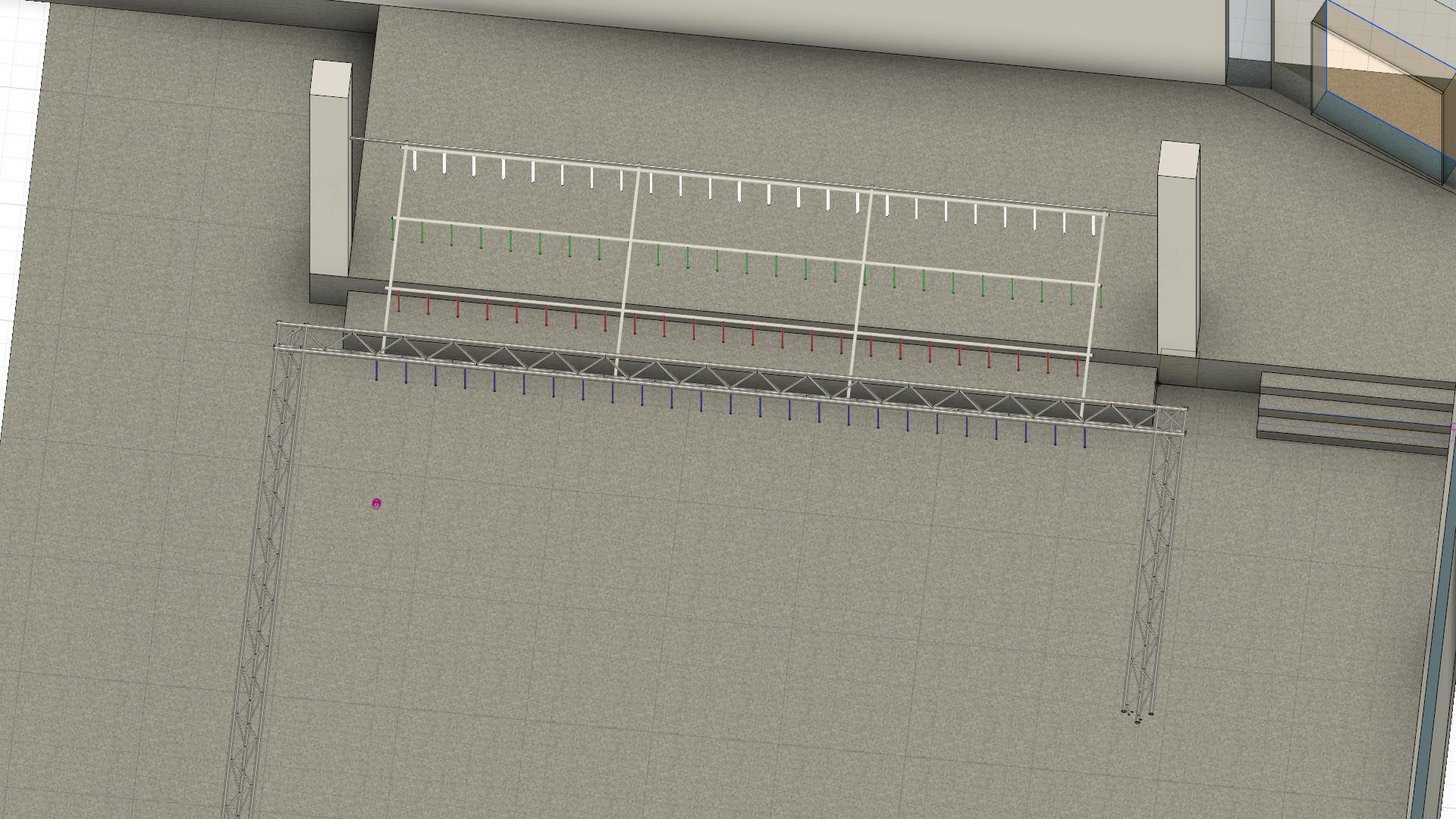

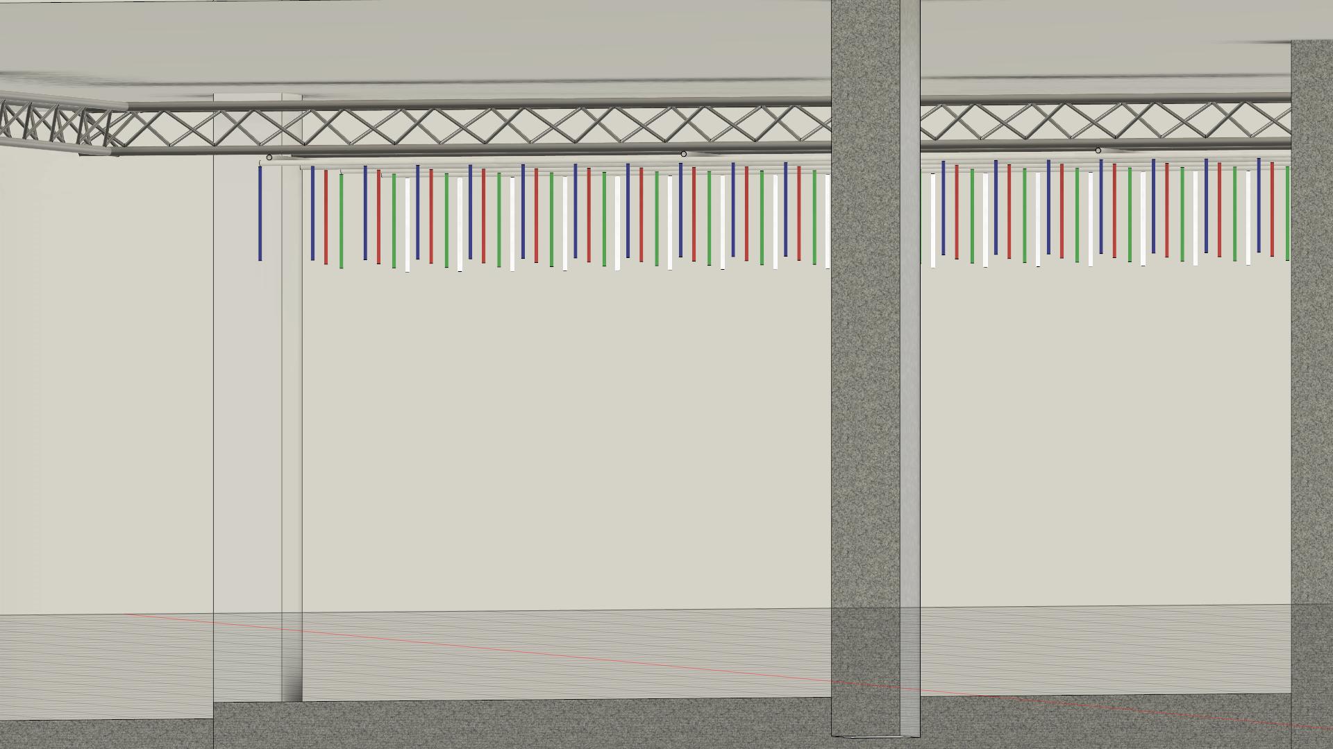

I am part of a team, we are currently working on a rather big project. I've attached some photos as wall as circuit diagramms so you can understand it better. We are building a LED "sky" out of 50 LED strips, 750 single LEDs. There are two options for wiring the data cable:
a)We are planning to have a single data wire to each of the LED strips.
1.As you can see in the skecht below, we want to run for example a color Wipe on all the strips the same time. So I need a comman/way to say: colorWipe(strip1 to 50.Color(255, 0, 0), 50); instead of as seen in the sketch.
And can I use this command also here: Adafruit_NeoPixel strip1 = Adafruit_NeoPixel(15, PIN1, NEO_GRB + NEO_KHZ800);

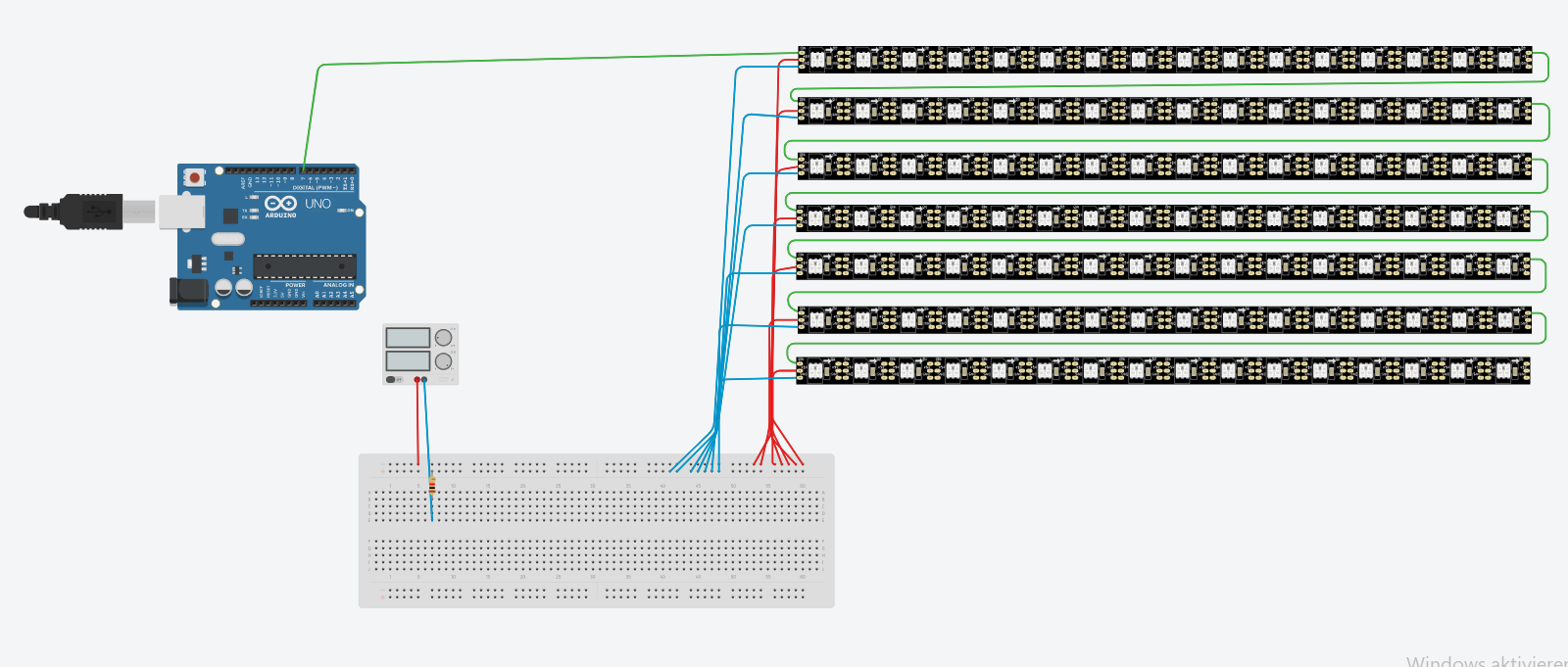

b)Or if this is a better option we want to connect one bar of LED strips(would be 12 strips) with one wire. But I dont really know if the commands would still work as the programm see would see the 12 strips as on strip.
2.So is there are way to run a effect like colorWipe on 12 strips simultaneously, if the sketch thinks its just one big strip?

The method you suggested using Adafruit_neopixel will work just fine, but no built-in function for doing a swipe on multiple strips is available, though if you are doing a project like this with a few people, someone should have enough time to look and see how this function is created within the library and set that up so that it can.
There is no real benefit for using multiple pins other than 'if you chain breaks you lose less of the whole' and 'like that i can run shorter wires'
The second argument is something to consider, the length of a data-wire is limited as a result of the capacitance of the cable causing the signal to be disturbed (thinner wire is better !, solid is better than multi-strand)

I guess wiring them up in one huge strip makes the most sense, considiring it works in the code.

Yes, we are probably using 4 PINs as we have got 4 rows out of 12 to 13 LED strips.

Adafruit_NeoPixel strip[ ledStrips ];  // I only bet this is possible knowing how C++ works, try it with just 2 strips to test. but what about the other arguments to the object ?
Adafruit_NeoPixel strip2 = Adafruit_NeoPixel(15, PIN2, NEO_GRB + NEO_KHZ800);
the pin number & the amount of leds don't have a default value.
and to get back to the title of this thread
Command to run 2 or more LED strips simultaneously
you can update them 1 at a time but very quickly after each other, totally simultaneously although theoretically possible, will probably be a bit much for the CPU.
The MEGA should be fine for what you want to do and the well, use thick cables for power & Ground and a thinner one for data.
Yes this would be me, but I don't think I understand programming enough to find how this function is creasted.
Don't underestimate yourself, use an editor like notepad++ to have a look in the library's .cpp file and see if you can work it out, start with the easy ones like fillSolid(), go through a loop in your mind and figure out what is different next time around and how the parameters (arguments) to a function are used to change things.
