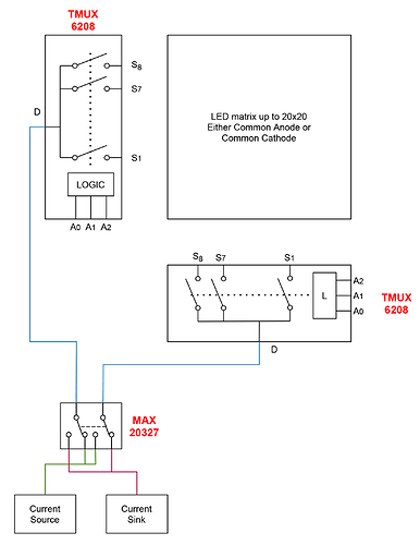

My first approach is as follow:
There are two TMUX6208 which are 8:1 bidirectional mux/demux, their purpose is to select the row/column. Then the MAX20327 since is just a pair of spdt switches will define the current flow.
This is my broad idea so far, and it lacks a lot. I don't know/ haven't thought if either I should place a current source, or I should sink it.
There could be a component that already does this job and I haven't seen it.
Bidirectional multiplexers are totally inappropriate for this purpose.

Can I know why do multiplexers are inappropriate?

Thank you both for the answers but I still don't completely get how to drive both common anode and common cathode with the same setup.

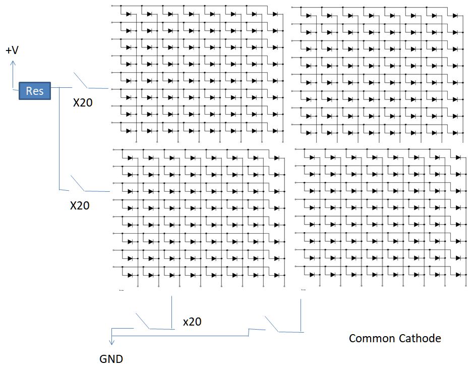

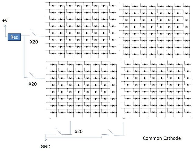

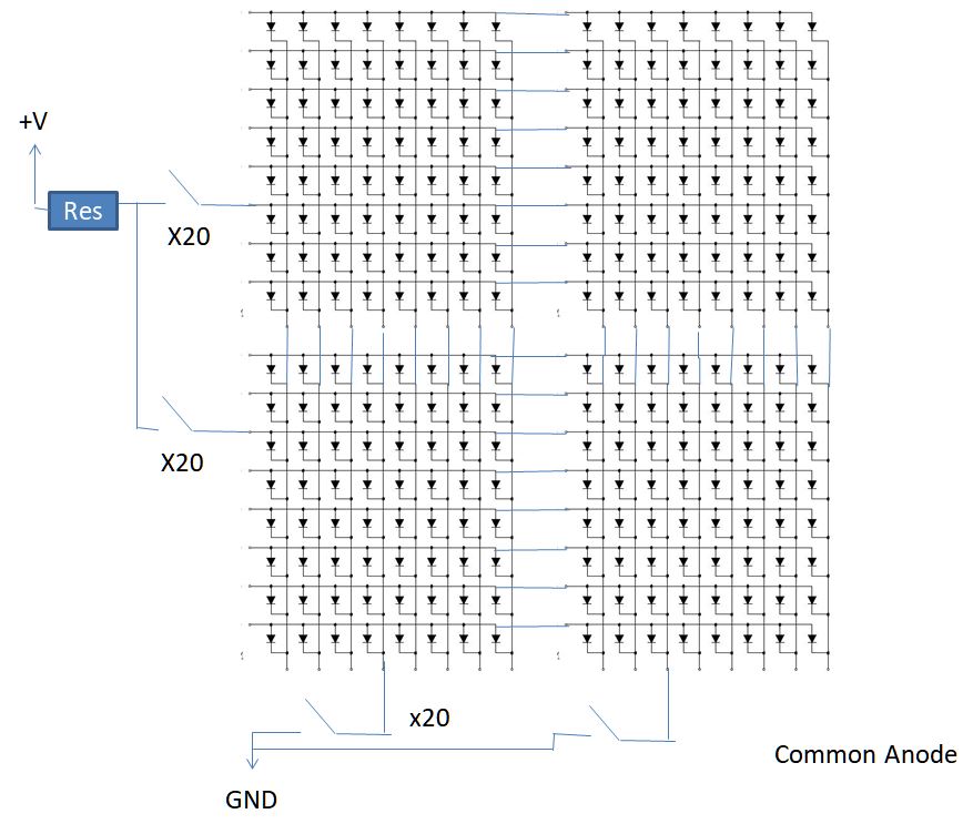

As you are only going to be driving 1 LED at a time, those 30mA capable muxes should work.
As you can see in the attached, there is really no difference between Common Anode & Common Cathode matrixes. It's just a matter of how you wire them up.
I used the schematic from a common anode & common cathode display to show that.
If you are planning to multiplex this display to give the appearance of more than 1 LED being on at the same time,
that might end up appearing as a dim overall display, with just 1 of 400 LEDs being on at any one time.
With 30 frames a second refresh rate = 33.3ms, split over 400 LEDs = 0.08325 mS on time for each LED, which may not even be viewable.
