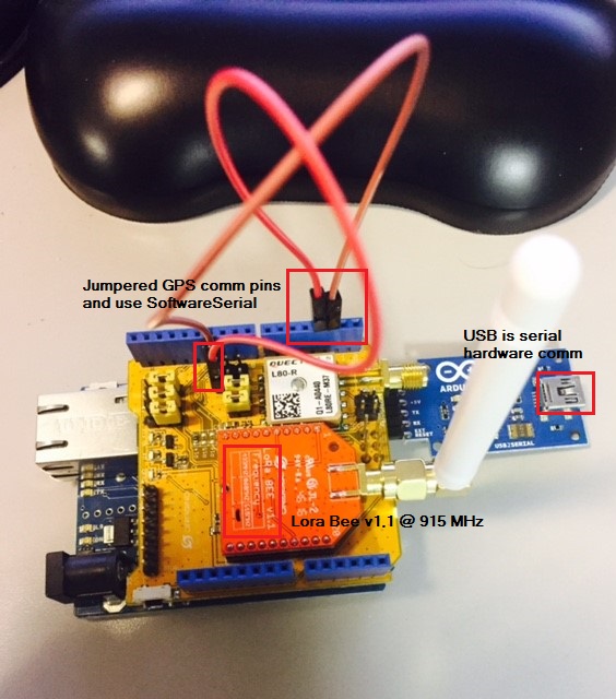

I have an Arduino Uno and an Arduino Ethernet board. Either one I've tried to connect my Dragino Lora GPS shield atop and get to work. For both GPS and LoRA purposes. So far I've gotten the GPS working, but cannot get the LoRA to function.
I've tried the sample code to send messages to the LoRA but cannot get the rf95.init() to return as true.

But even then I cannot initialize it. Since I am using the USB port as my serial connection for loading code into the Arduino Uno or Arduino Ethernet board, I had to jumper the GPS and use SoftwareSerial for it. What about the LoRA Bee that sits atop the Dragino LoRA GPS shield? It just plugs atop the shield and I wouldn't imagine I'd need to jumper that component, right?
Otherwise I am fine with these components. I can read GPS data and send it via the USB serial link to monitor the output. I just cannot initialize the LoRA bee...
Attached is a pic my setup. Arduino Ethernet with Dragino Lora GPS Shield atop. I communicate via USB as hardware serial, jumpered the GPS to use SoftwareSerial, and the Lora Bee is v1.1 and supposedly hard-coded for 915MHz. Not sure if I need to specify parameters when constructing the RF95 singleton instance. If I do I'm unsure what the parameters are? :frowning:

Disregard. Newbie admittedly here. I thought the Arduino Ethernet and the Arduino Uno were pretty similar, except for the difference of one having a USB connector and the other an Ethernet connector. Apparently Pin 10 that LoRA uses as its slave select pin was taken up by Ethernet. After switching back to my Arduino Uno the RF is initialized.
Getting there...slowly but surely... :slight_smile:
