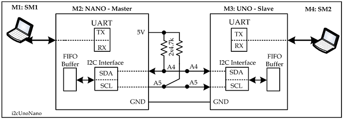

Also i got them connected like:
UNO TX (pd1)-> NANO RX (pd0)
UNO RX (pd0)-> NANO TX (pd1)
UNO GND-> NANO GND

yes, i'm trying to implement I2C protocols. So i use TX, RX and wire library... it isn't right?, why you say im using Serial? sorry i can't see the problem
THANKS, I UNDERSTOOD... SO MUCH THANKS, I WAS DEALING WITH THAT NONSENSE ALLE THE MORNING! :slight_smile: :slight_smile:

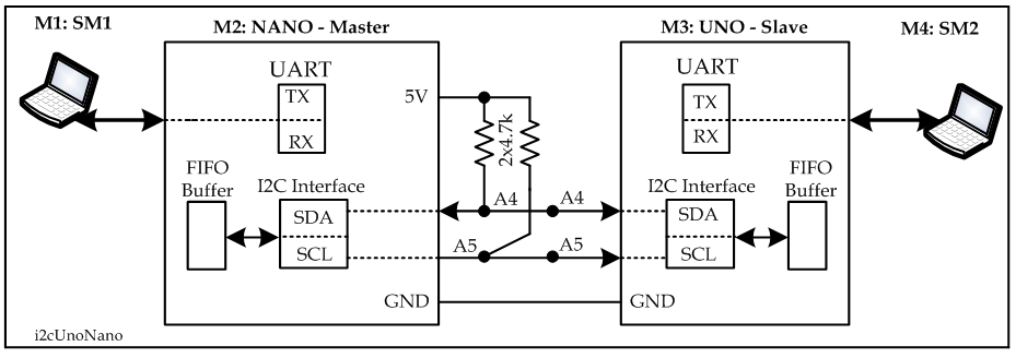

I2C is not serial. The UNO and the Nano use pins A4 and A5 for SDA and SCL. Connect those together with a pullup of 2K to 10K on each line then the wire.h functions should work.
As stated before, show your schematic.
1. Make connection between NANO and UNO as per following diagram (Fig-1) using I2C Bus.
Figure-1:
