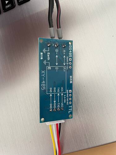

Hi Everyone, I am trying to read holding register of a electromagnetic flowmeter Proline Promag P 300 via RS485 using Modbus RTU but unable to do. I am new to Arduino and getting so much confused by different library e.g. ModbusMaster.h and SimpleModbusMaster.h etc.
I am using RS-485 toTTL to module and also have 1 arduino mega.

and module what i use:
Please help me out and thanks in advance.

Did you change the parameters, address defaults to 247, baud defaults to 19,200??
per your pdf anyways..
good luck.. ~q
