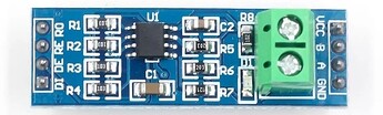

Do you already have an RS-485 to TTL adapter ?, such as this one :
I noticed from the MFM384-R-C manual that the RS-485 terminals on the energy meter are labelled '+' and '-', rather than 'A' and 'B'.
There is supposedly a standard that says that the 'A' terminal is '-' and the 'B' terminal is '+', but that isn't always the case.
If you have a multimeter you could check the polarity of the 'A' and 'B' terminals.
You might have to get the polarity right by trial and error, only one way will work, but no damage will result from getting it wrong.
