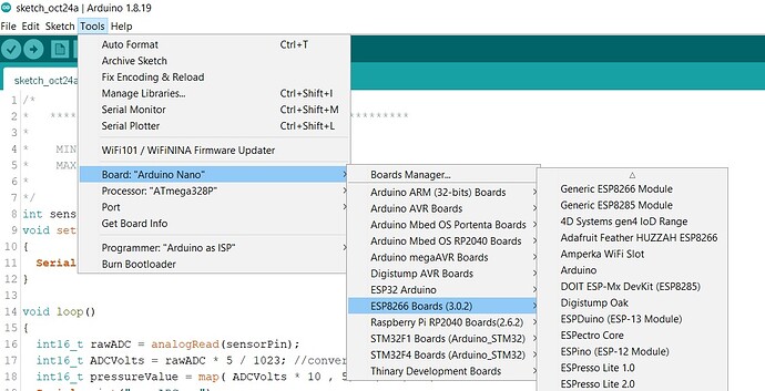

Perhaps you're trying to compile code meant to run on an ESP8266 with the IDE's board type set to Uno?
Arduino: 1.8.17 Hourly Build 2021/09/06 02:33 (Windows 10), Board: "Arduino Uno"
What model Arduino controller have you selected in your IDE?? UNO???
I even didn't notice :slight_smile:
Tools->Board:->Arduino AVR Boards->Arduino Uno
The library IRremoteESP8266 can't be used with Uno
And then select from the right hand list.
Does this mean this will not work with an Uno? Maybe Uno Wifi Rev2?
I want to use this because it has support for Fujitsu, which is the HVAC remote I'm trying to pull codes. IRremote seems to not function properly with my Fujitsu AR-RCF1U remote. The codes seem to be irregular or repetitive
Yes, you need the hardware of the ESP8266 for the code to run.
Well, that's a bummer. Thank you
Hope there's something that can run on an Uno and support Fujitsu, perhaps it can be added to IRremote from IRremoteESP8266?
Google;
ir remote arduino uno
If you don't want Wifi etc.
Tom... :smiley::+1: :coffee: :australia:
Thank you.
Will try getting something working with a sample in IRremote
"algorithm" is part of the C++ standard template library (STL), and the #include <algorithm> syntax is correct.
ESP8266 Arduinos have access to that feature, but it's not implemented for AVRs (much of the usual STL depends on stuff that is unlikely to work very-low-memory CPUs like the AVR.)
There are IR libraries for Uno that will probably work fine.
