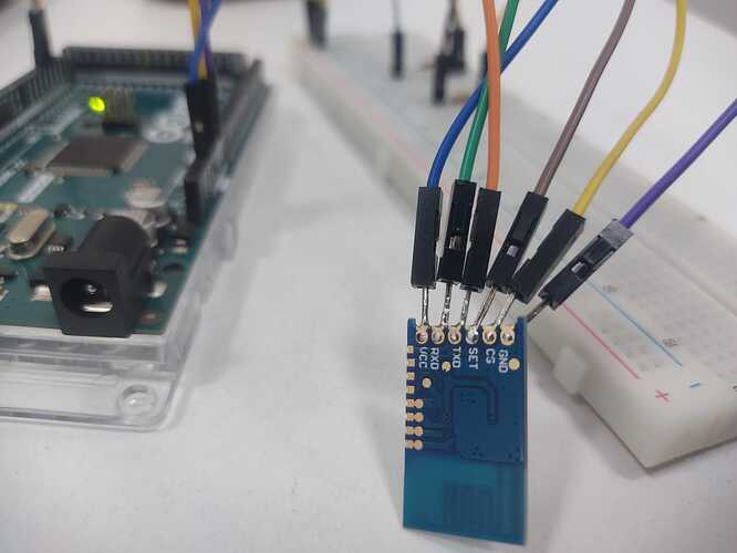

Here are my connections. I can't get a response. I made a voltage divider for the Arduino mega RX pin. (With 10k and 4.7k resistors)

Note the similarities. Which is to say: could you please post a schematic or wiring diagram of your setup to go with the photos? Photos generally help fill in the possible gaps that a schematic may leave.

Are these pins soldered or not? Why not to solder a standard pins header instead this?
pins soldered

I think you have problems with the physical connection. Your soldering does not look very reliable. In addition, the pin headers on the Mega also often have poor contact with the wires

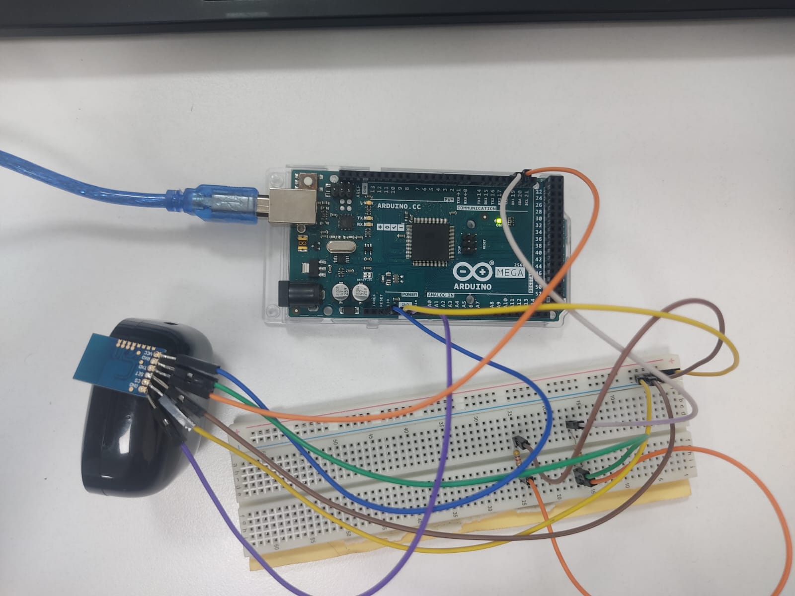

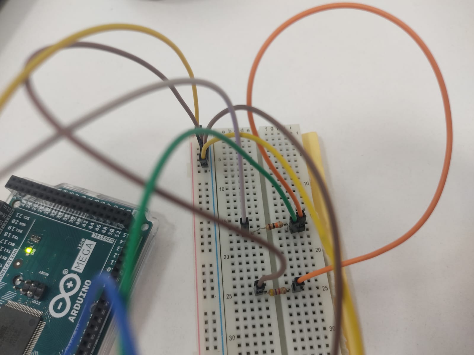

You were asked to show a photo to check the correctness of the connections. But your pictures do not allow this to be done, because they do not show the numbers of the Mega pins where the wires are connected.
In addition, the colors of the wires are also usually chosen not by chance, but taking into account certain rules. Usually, the power "plus" (VCC) is chosen in red, and the GND is black or brown. Both of your power wires are blue - this increases confusion

I only entered 3.3V/ GND/ TX1/ RX1 pins on the Mega with a jumper cable.
Apart from that, my connections are already
VCC >>3.3V
GND>>GND
Rx>> Voltage divider and Tx (mega's TX>10k>JDY-40 Rx)(mega's TX>10k>4.7k>GND)
Tx>> Rx
CS>>GND like this.

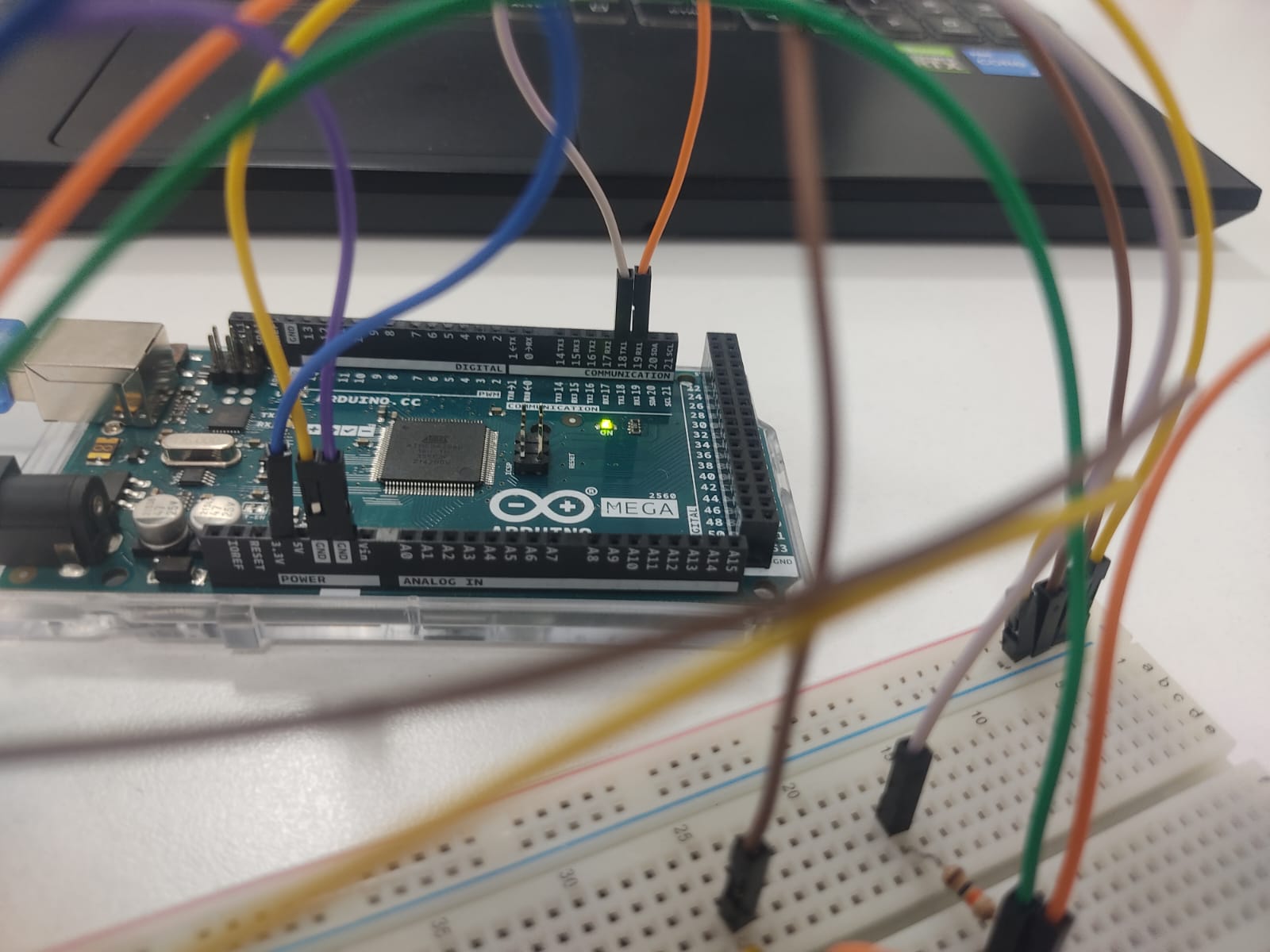

Stepping aside the incorrect nomenclature for the Arduino pins (I assume you mean "TX1" and "RX1" instead of "Tx" and "Rx") - can you confirm this is connected to the correct pins:
Which pins does Serial1 in your sketch align with on the Mega board?

There's still no wiring diagram, which would clarify this issue.
I think you need to pay attention to details more. Sloppiness doesn't jive well with embedded systems engineering.
