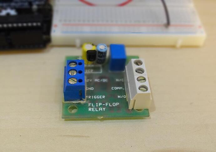

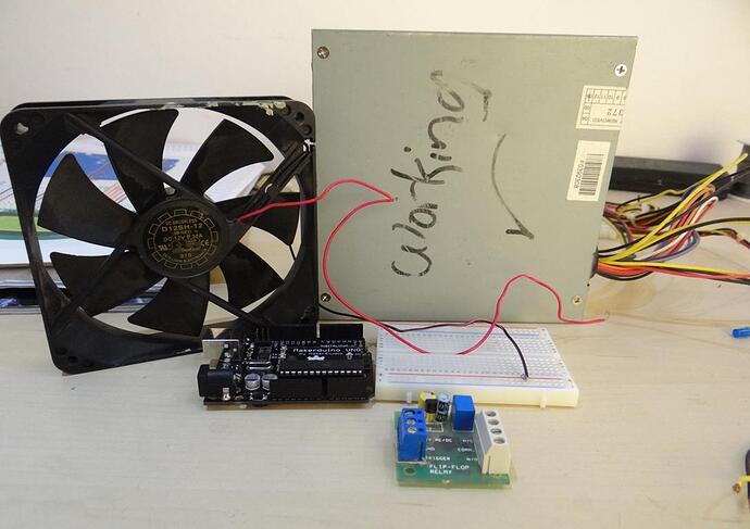

This is what i have:
1 X Arduino UNO R3
1 X Relay (don't know what type it is.. lol)
1 X 12V Fan
1 X 12V Power Supply (external power source for the fan/relay)
1 X Breadboard
Please have a look at what i have, from the image posted.

Ditch the relay look at MOSFET's in the playground. A 12V fan should not be controlled via a relay. You could also look at motor controllers. There is one in the products section here that should do the job!.
Relays are for fools.
Mark
Ditch the relay look at MOSFET's in the playground. A 12V fan should not be controlled via a relay. Relays are for fools.
I hope you are joking with that BS. :slight_smile:
This tutorial shows how to run a motor from a transistor, and here is how to switch a relay with a transistor.
Since it seems one should use a transistor to switch a relay, you might as well just use the transistor to switch the motor, unless the motor is so huge that it is beyond the capabilities of the transistor and actually needs a relay.
I love those UMass tuts- the schematics and photos are cool 8)
Relays can electrically isolate the arduino from the load being switched. Transistors maybe not so much.
