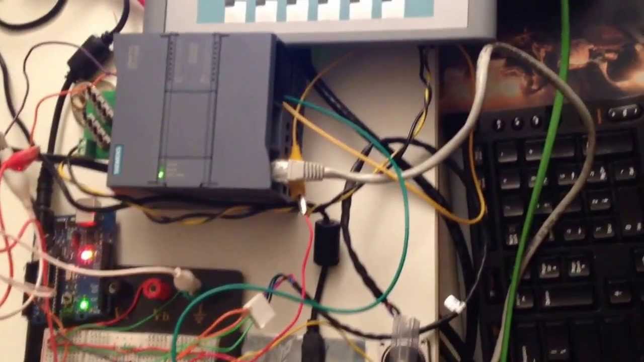

I saw this very interesting video on youtube where an arduino interfaces with an Siemens S7-1200.
Does anybody have an idea how he makes the interface between the arduino and the PLC ?

It looks like is using serial or modbus rtu?
Im currently trying to get a arduino ethernet to be a modbus tcp slave for the plc. So i can connect all sorts of sensor to it, and do some datalogging on the plc.
I don't know exactly whether the Siemens S7-1200 supports modbus communication protocol but in case it is, you can use serial RX/TX Arduino lines, some MAX485 chips together with the Arduino modbus RTU library. It works fine.
A good pointer for Arduino rs485 communication might be the following:
eventually, if it supports modbus tcp:
I hope it helps

Yes, the 1200 can do modbus RS232, RS485 or Modbus TCP I wish there was a nano wiznet shield.
I have the nano as a modbus TCP device with a DTH11 for temp and humidity.
I have been thinking this would be a great device to save wiring if you have a few signals and the plant has ethernet could save a lot of wiring cost. The main issue is how do you mount and wire it?
Here is a link for the S7 code
