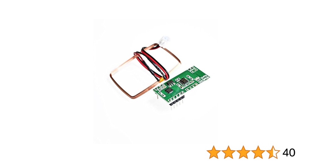

At this point, it might be better to use directly a reader of rfid?
I found this one that works with the frequency of our badges:
DollaTek RDM6300 Modulo Lettore RFID 125Khz EM4100 Modulo Controllo accessi Uscita UART per Arduino
amzn.eu
](https://amzn.eu/d/enPdKnt)
UART exit, so can I connect it to pins 0 and 1 of R4 Wi-Fi? And the directly read from Serial?

Thanks a lot: I think this is the right reader since the frequency, 125 kHz, is the one of the tags, same for standard, EM 4100
T.
Thanks for your suggestion: I already dealt with that, but now I know frequency and standard.
Probably I’ll try to use directly an RFID coil and pcb with an UART output, so I can bypass the conversion from USB reader.
