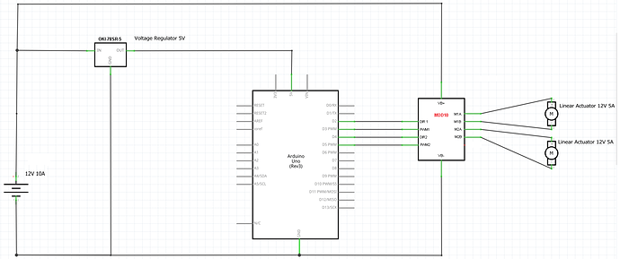

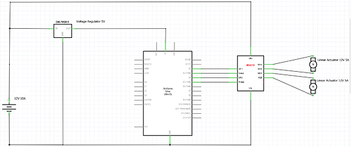

Hello,
I have already made a new diagram using MDD10 Motor Controller,
Could you please check If it is ok?
Some of my concerns are:
  • Be sure if the feed of 12 volts for the motors, and 5 volts for arduino are correct and can live together as shown.
  • Be sure if the wiring for the arduino, driver and motors is correct since it looks kind of simple.
In the post I have added the datasheet of the Motor Driver MDD10, and the image of my schematic.
----> Thanks a lot in advance.
Datasheet of MDD10 link: https://www.robotshop.com/media/files/content/c/cyt/pdf/cytron-10a-7-30v-dual-channel-dc-motor-driver-shield-datasheet.pdf
cytron-10a-7-30v-dual-channel-dc-motor-driver-shield-datasheet.pdf (1.42 MB)
It's not a good idea to force an LM7805 to dissipate 7V (12-5=7) unless it is well heatsinked and preferably
fan cooled. Failure to provide sufficient heat sinking or cooling or both will result in the regulator running hot. It can shutdown if it gets too hot. It is advisable that you get a DS18B20 TEMP sensor and mount it
directly on the LM7805 to monitor the temp. It is very easy to use. Just Google "arduino DS18B20" and you'll find millions of hits.

Good day,
Or use a switching regulator to make 5V for the Arduino.
One example https://www.digikey.com/product-detail/en/murata-power-solutions-inc/OKI-78SR-5-1.5-W36-C/811-2196-5-ND/2259781
I am wondering if this is the most natural option to use only one power supply(12v) and feed arduino and the motors, or exist another better options?
I wouldn't say it's the "most natural" since it is preferable to have the processor running off a supply that
is not subject to the load demands of a motor driven system. Theoretically, if you 12V supply is solid enough and you have enough filter caps on both the 5V rail and the 12V rail to absorb spikes from the
motors, then it should be ok. Without a storage scope to save screenshots of the power rails at the moment the actuator starts moving, the only way you can monitor the system is use analog inputs to measure the 5V and a voltage divider to measure the 12V and log some data points before , during and after driving
the actuator and if you see any substantial dip in the voltage then add 470uF ,1000uf, 3,300 uF wherever
you see the dip. (lower values for the 5V and larger values for the 12V)
Have you got the capacitors specified in the LM7805 datasheet?
They are very important to proper operation of the regulator.
Tom... :slight_smile:

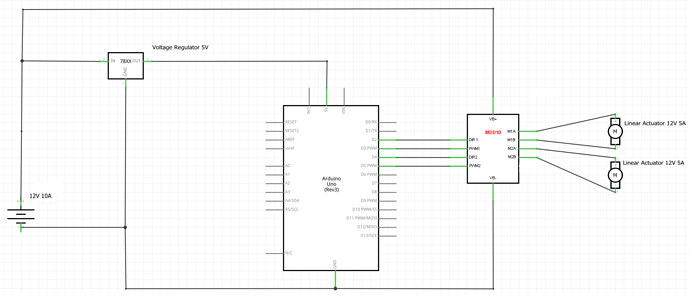

CrossRoads:
One example OKI-78SR-5/1.5-W36-C Murata Power Solutions Inc. | Power Supplies - Board Mount | DigiKey
Based on your comments I see that using the linear regulator(7805) could have heating problems, so you recommend using the switching regulator(OKI-78SR-5) which is more efficient. Below is the new schematic, which is only replacing 7805 by OKI-78SR-5.
So this solution would work fine?
I was checking also another solution that would be to use the arduino 12V DC Vin which has a built-in linear regulator.
What do you think? ,Tell me your thoughts.
Thanks
Best Regards.
