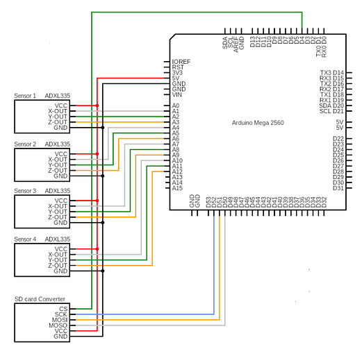

Connect two Mega 2560 boards with ADXL335 sensors
I'm currently working on a project where I should use multiple ADXL335 sensors (8 total), since the arduino mega 2560 only have 16 analog pins which allow me to add 5 sensors, I brought an extra board so I can add twice the amount of sensors.
I'm not aware how I can get the two boards to communicate, so the sensors (accelerometers) record at the same time with the same sample frequency.
I have uploaded the code for 4 sensors working on one arduino board, pls help with the connection.

You can use any of the available communication interfaces - UART (Serial), I2C, SPI ...
UART might be easiest, as you can test & monitor that against a terminal on a PC ...
Seems a bit excessive to add a whole extra Mega 2560 board just for that!

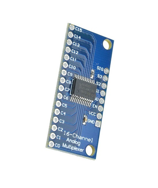

Have you considered an analogue multiplexer?
An analog multiplexer would be a far better approach. You could do this with a much smaller Arduino, if the analog signals are all your wishing to attach.
You need to tell us how often you want to sample, if there's any problem doing round-robin sampling(i.e. non-simultaneous sampling), etc. As well as what you're doing with the data. This will all play into a 'best answer'.
Remember, "as fast as possible" and "simultaneous" are wishes, not specifications.

I also have a analog mulitplexer. The sampling frequency should at least be 30Hz, the higher the better.

Can you provide more info on how to add the mulitplexer physically and code wise?

What multiplexer, exactly, do you have? Please give a link.
A multiplexer allows you to switch multiple source to one input.
So you just need to select the first source, read the input, then select the 2nd source, read it, etc...

CD74HC4067 16 Channel Analog Multiplexer Module
Hmm.. not sure, I collect all the data with an SD card micro unit, so full code I use is here.
I also use my PC to monitor the recordings.

Yes, but we only have analog sensors.
What, exactly, do you mean by "sensor" here?
The ADXL335 is an electronic component; there are digital versions in the ADXLxxx range - see the 'Output Type' column here:
Perhaps, the equipment has been purchased, and budget prevents buying more?
@jakob1314 We really do need a complete project description, along with a schematic of what you have so far. It's disappointing to try to help, only to see more details come out that make the help meaningless.
Yes, I'm getting the impression that "sensor" here means something more than just the accelerometer chip...
Sorry, no by sensor I only mean the ADXL335 accelerometer.
I would like to increase sample freq. and add 4 ADXL335 components more to the system.
So why not use a digital accelerometer instead?
Or, at least, make the extras digital?
