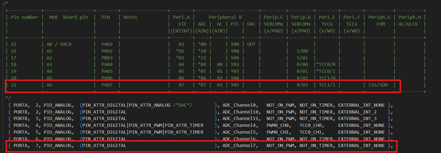

I am using an Arduino MKR GSM 1400 (Atmel SAMD21)
I want to use Pin PA07 as PWM pin, on the data sheet it says it is possible but sadly the core arduino libray doesnt support it by default.
I did confirm the pin is connected and to PWM channel by changing the variant like this -
I now want to opreate the pin as PWM with the original variant so I tried to run this sketch (Chat GPT wrote most of it)

It doesnt work of course.
Does anyone knows why it doenst work?

I didn't see any relevant example on the IDE, and didn't find somthing that worked over the internet.
i'm not familiar with Arduino MKR GSM 1400, but analogwrite (PinNum) is all that's need to generate a PWM output on Arduino and comparable boards
