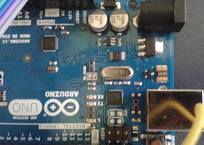

Attached is a picture of the Arduino board. So I remove the crystal and then the capacitor to the GND. But, I am not quite sure which one is the capacitor (I think I can see two of them). Also, where is the XTAL1 pin?

There are THREE styles of surface mount ATmega328P and they have the XTAL1 pin in different places. Pins are numbered counterclockwise from the Pin 1 mark (dot or clipped corner).
32-pin TQFP: Pin 7
28-pin MLF: Pin 5
32-pin MLF: Pin 7
If I counted the 7 pins correctly the XTAL 1 pin is at the 5v pin. Does that sound normal? Also, I am not quite sure if I should count only the 'female' pins, or the male as well. And about the capacitor to the ground, where exactly is it located? Sorry for the multiple questions, and thanks again for your help.
In your picture, look at the 32-pin square chip to the left and up from the can marked T16.000. That is the ATmega328P processor. The Pin 1 marker is in the lower left corner. Counting across the bottom from left to right you have pins 1 through 8. Pin 7 (XTAL1) and Pin 8 (XTAL2) go down to the small surface-mount component and onward to a tiny metal can with six pins. THAT tiny metal can is the resonator. The larger can marked T16.000 is the crystal for the USB-to-Serial chip. Use heat to desolder and remove the tiny can (resonator) and the surface-mount component. Connect the clock to the trace that goes to Pin 7.

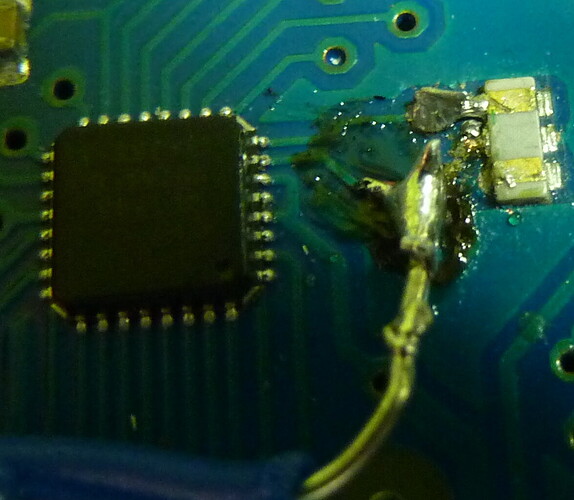

So, I think I messed up. I removed the small surface-mount component and the tiny can(couldn't remove it completely).Then I soldered a wire from the Clock 0 of the clock generator to pin 7. Then, I tried to run the sketch that came with the clock generator library. The sketch basically generates 3 signals and shows you how you can modify them. I got the error avrdude: stk500_recv(): programmer is not responding. Attached is a picture of the current situation. I tried other sketches as well. None of them worked.
Without the clock running your Arduino will do nothing. If you don't have the clock running BEFORE you try to upload a sketch you won't be able to upload a sketch.
And how can I make the clock run beforehand? Thanks.

Maybe you could get a second Arduino to control the clock.
I guess that's what I have to do. What model do you recommend and how can I make sure that it is genuine?
