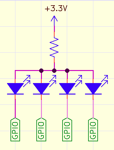

Thank you All for your feedback. I forgot to add that I have 10 LEDs that I have to control separately and only 1 LED will be switched ON each time. I wonder if I can use only 1 resistor between all LEDs and their GND (see below)
GPIO1 ----|>---- LED1 ----|
GPIO2 ----|>---- LED2 ----|
GPIO3 ----|>---- LED3 ----|
GPIO4 ----|>---- LED4 ----|----[R]---- GND
GPIO5 ----|>---- LED5 ----|
GPIO6 ----|>---- LED6 ----|
GPIO7 ----|>---- LED7 ----|
GPIO8 ----|>---- LED8 ----|
GPIO9 ----|>---- LED9 ----|
GPIO10 ---|>---- LED10 ---|
This is the conventional way to use an LED.
You use the GPIO as a current sink.
To turn on the LED you set the output LOW.
Yes you can use one resistor.
Red and Green work OK on an ESP but some Blue may not work.
In the case you have mentioned, i.e. only one led at any one time is switched on, then you can do this. If, however, multiple leds can be on simultaneously, then the brightness changes depending on how many leds are currently on. This may not be desirable.
