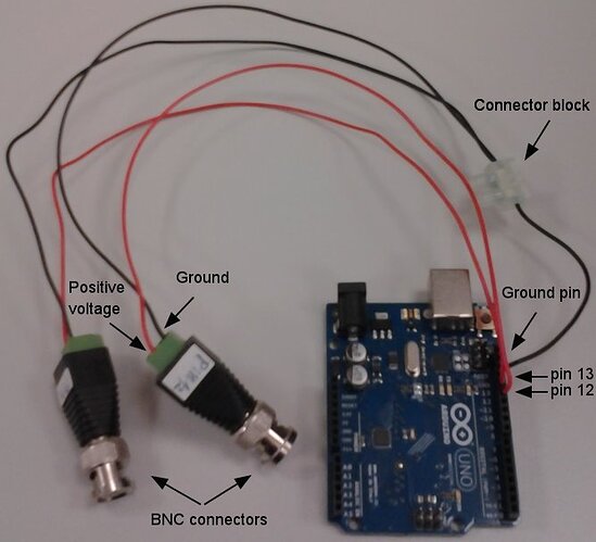

I have this proyect my professor assigned related to pH in which I connect the pH probe provided by him to an Arduino that measures the pH in the solution (e.g. water). The thing is there are usually some modules that come with the whole the analog ph measurement kit that involve some op-amp and stuff, all those things I don't have. He told me to connect it directly but doing some reasearch I learned the negative pH damages the Arduino board and I need and amplifying phase so I can amplify mV to V. The problem is I really don't know what to use, which op-amp or how the wiring is made.

Below I'm attaching the wiring scheme that I searched and showed to my professor which he said it was okay and to do it. After much asking on and on I'm not sure of this.
Well it is not going to damage the Arduino. Then again it will do absolutely nothing. And anyway that is not a schematic it is a photograph!

Without a data sheet you don’t stand a chance. Connecting a PH sensor to a digital pin shows you know nothing about PH sensors nor digital pins. What are you hoping to see?

Input impedance of your analog inputs of the Arduino is too low by at least three orders of magnitude to read an pH probe. That's why it won't work. There's a reason a pH probe connects to a shielded wire and BNC connector, instead of a regular wire!
