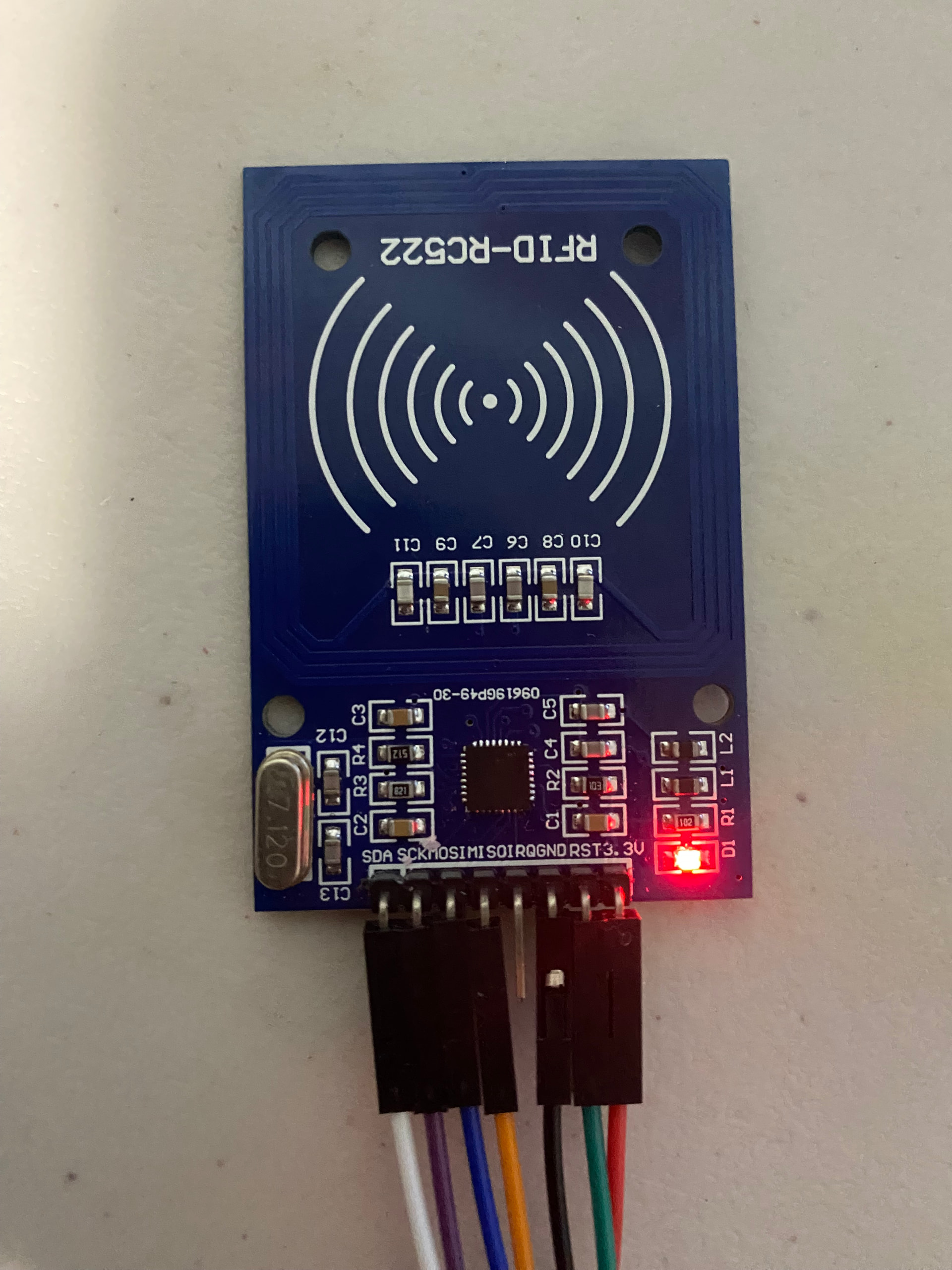

I am trying to connect my rfid rc522 reader to the esp32 display, but I don't know how to connect and code in. I am doing a inventory system where if I scan a tag, it deduct the item's quantity by one.
My goal is to make the touchscreen + rfid work but I have been struggling with that. The touchscreen is working, but the rfid doesn't work. Any help is appreciated!

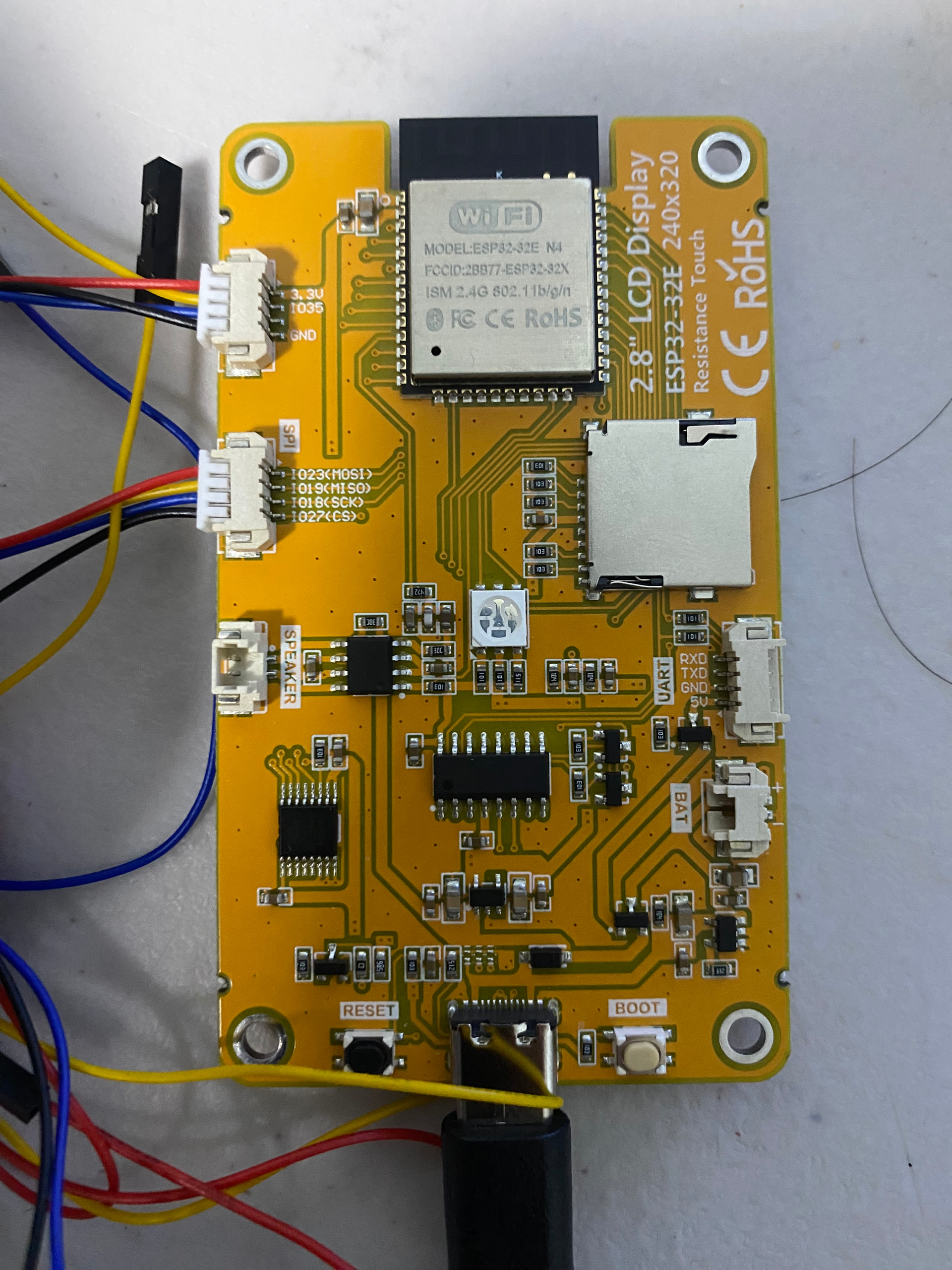

My esp32: Amazon.com: Hosyond 3.2'' ESP32 LCD Display Resistive Touchscreen with WiFi+BT, ST7789P3 Driver 240x320 TFT SPI Screen Module for Arduino : Electronics
Look for example code for the rfid and try to incorporate it in the code You have.
the link you gave does not appear to be the same TFT display as in your photo in post 1
I find it a good idea with the CYDs to get a schematic
have you had the RFID working in a separate program?
I would suggest using HSPI
I got it figured it out. I just search some examples of rc522 code and i just combine my code together. But thank you for your suggestion!
There are a considerable number of variants of the "Cheap Yellow Display" (CYD) but with the common factor that the PCB solder mask is yellow. However, even there with some exceptions. Here is a black "CYD" Freenove ESP32-S3 ESP32 S3 Capacitive Touch Display CYD WiFi BT, 2.8 I
The OP's display has a completely different layout to the two 2.8" models that I have now acquired so some care is required if purchasing an optional case for these together with the difficulty of finding a matching schematic.
too true! I have 2.8" and 4" Freenove_ESP32_Displays
for the 2.8" SPI I use
//  CYD_2.8_inch_FREENOVE_ESP32 pins used by MFRC522 RFID reader (VCC to 3.3V)
#define SCK 22
#define MISO 35
#define MOSI 27
#define CS 21
SPIClass *vspi = new SPIClass(VSPI);       // VSPI object used by MFRC522
vspi->begin(SCK, MISO, MOSI, CS);
at least Freenove supply schematics which I find essential in sorting out CYD GPIOs
