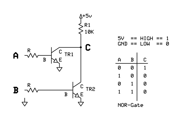

Open collector or drain outputs are designed for the possibility of wired-OR logic. Just connect them together, with a pullup resistor and connect to an INT pin. Connect all the grounds, of course.

Investigate reply #1 carefully. You don't need any hardware beyond a pullup resistor for this.
Truth Table, two NPN open collector.
