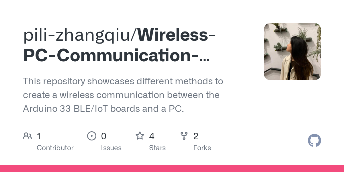

If you are familiar with BLE programming, this page may help. It is for the Arduino Nano 33 BLE that uses the nrf52480.
One sends its data, the other gets it - and "echoes" to the PC.
Thank you!
Thanks for your example!
