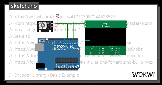

what is the problem? i ran the code with some buttons and saw counts from detectRotation() increasing and decreasing in value. Why are CCW events only counted if netCount1 > 0
i'm still unclear on what the sensors are detecting. And confused by if the comment is talking about individual sensors overlapping or the output for the two encoders -- each encoder has two hall sensors that need to overlap. Can you post a diagram

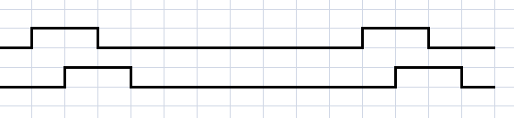

Looking at the sensor photo in post 17 -
If you could add one or two additional magnets to effectively make one long magnet it might work like this:
And you'd get a quadrature type directional signal once per revolution.
YMMV

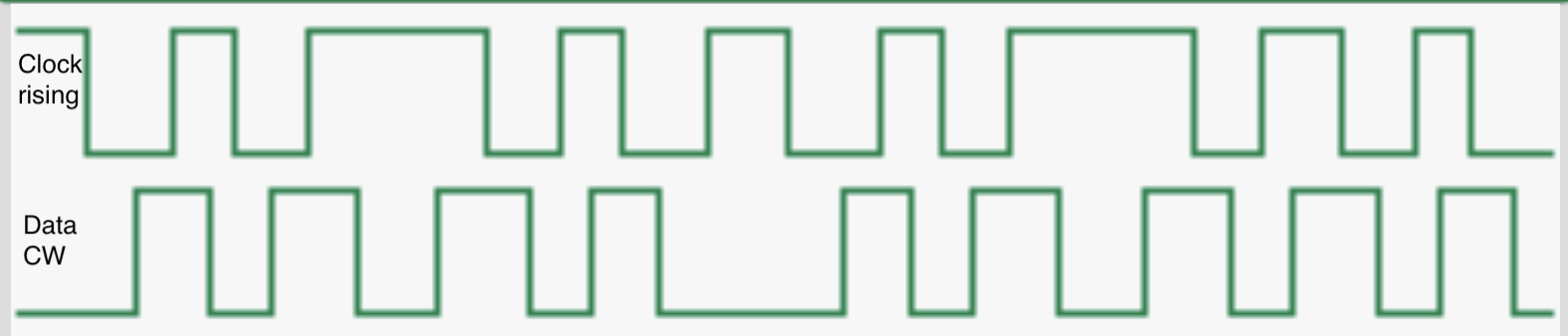

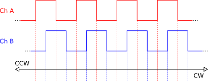

why is this different that ny quadrature encoder, and it appears that yours works.
A common approach is to look for either a rising and falling transition on one input and then looking at the state of the other input to determine if the direciton and whether to inc/decrement a count
your approach is to look for a Low-to-High transition on either input AND that the other input is LOW to determine whether to inc/decrement a count. This approach may only work in your case if the AND condition is that the other input is HIGH instead of LOW

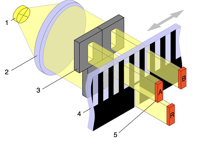

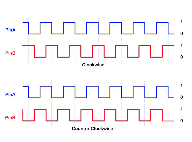

I am having some confusion about how the sensors should be situated around the rotor. Most sources say they should be set at 90 degrees apart:
"The two Hall effect sensors should be positioned 90 degrees apart relative to each other around the rotor. This means that if you imagine the rotor as a clock face, one sensor would be at the 12 o'clock position and the other at the 3 o'clock position."
What confused me is that when I saw patterns like your Ch A Ch B on oscilloscopes it looked like the sensors needed to be close enough so that the HIGH from one was being read while the other was reading low. So, I thought this meant the sensors needed to be close together. That's probably a dumb conclusion, but since I was operating without any outside input, that's what I thought. My sensors are close together. So, last night I decided to reposition the magnets to be 90 degrees apart. That is not so simple because the support for the sensors has to be completely reconfigured. Anyway, in removing and reinstalling the sensors, I screwed something up so they are not being read now. I kept having the plastic covered pins fall out or become loose and so I tried to solder the wires to the pins and I think I damaged the module somehow. So, I can’t test the 90-degree arrangement until I can get new sensors. I will have to take a pause.
Regarding the "quadrature encoder" when someone referred to that at the very beginning of this thread, I looked it up and it seemed like I involved the use of specific encoding devices that either were attached or integrated into a revolving shaft. Or conducting strips as used in a potentiometer were embedded on the rotor or wheel. But these didn't seem plausible since this has no central axil that spins. Maybe it is a concept that refers to how the signal is being processed and would work with the two hall sensor model that I am using. Again, I just didn't know how the code for the quadrature encoder could work with the dual sensor approach as well.
Yes. The output from the graphic illustrating a longer magnet in post #28 should look like this:
rather than the square wave for a regular encoder. One set of quadrature signals per revolution. You still have the phase difference to sense direction.
Can you give any additional details regarding how this should be set up? I thought you could have a single neodymium disc magnet on the rim of the rotor with the S side facing the sensor. The rotor turns and the hub is stationary. I have a startionary semi-circular stationary platform attached to the hub that holds the two Hall Effect modules with their chip facing outward so as to be passed overby the rotating magnet. I had placed the two modules side by side as I thought the trailing sensor needed to activate soon after the leading module. As in your diagram it looks like the trailing sensor started HIGH while the leading one was HIGH and falling off.
But most articles I've read on using 2 Hall Sensors to detect rotational direction say the sensors should be positioned 90 degrees apart relative to each other around the rotor. So it seems that the period of the two HIGHs would be separated by some discrete distance and not overlap as your diagram suggests. But this overlapping pattern is what the pattern looked like on the ocilloscopes pictures I have seen as well.
Sorry, still puzzled and confused. I need to get this sensor placement down with certainty before trying to solve the rest.

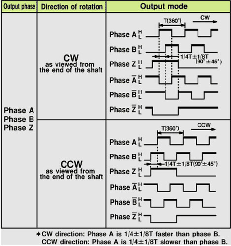

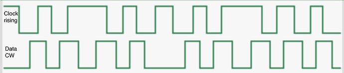

Here is an explanation I just read that favors having the sensors close together:
Explanation:
  • Placement:
The two Hall sensors are placed close together on the rotor's circumference, offset by a small angle (typically less than 90 degrees).
  • Magnet Rotation:
As the rotor rotates with the magnet on its rim, the magnetic field from the magnet passes over each sensor sequentially.
  • Signal Generation:
When the magnet's magnetic field passes over a sensor, the sensor generates a digital pulse (a high signal).
Determining Direction:
  • Clockwise Rotation:
If the magnet passes sensor A first, then sensor B, the rotation is considered clockwise.
  • Counterclockwise Rotation:
If the magnet passes sensor B first, then sensor A, the rotation is considered counterclockwise.
Key Points:
  • Signal Timing:
The slight offset between the sensors creates a time difference in the signal outputs, allowing the direction to be determined based on which sensor triggers first.
  • Digital Output:
Hall sensors typically provide a digital output (high or low) depending on the presence of a magnetic field.
The reason why this is such an important question for me is that my sketch only worked because I had to filter out spurious HH readings what were disrupting determination of direction and therefore correct net count. What I thought was error from errant code was coming from, what I assume, is sensor misplacement.
It turns out that one S1H S2L signal occured as the magnet entered the sensor field but as it left a S1H S2H was generated. I only saw this when I loosened the rotor from the geared motor shaft so I could manually turn it slowly allowing me to detect this anomaly.
So, even though my sketch seems to work, it seems like it only works because its filtering out these sensor outputs that I don't think are supposed to be happening

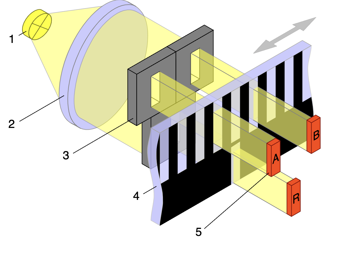

If a encoder has two outputs and the signal change from low to high of both channels start at different points in time but are overlapping each other before changing again this is called a qudrature encoder-signal.
And there are a lot of libraries with ready to use code for this. These libraries are doing all the details including counting up/down.
Your own code is just doing "give me the actual count"
The internal signal detection can b edone in different way. The most reliable one is the state-machine approach. Does not matter what the details are. Just the state-machine approach handles debouncing and direction-change very good.
So I recommend using the newEncoder-library
on robotics motors, with encoders, there is a magnetic disc attached to the shaft and hall sensors that are 120 deg apart. direction can be detected as long as the sensor outputs overlaps, hopefully made clear by the diagrams above
As pointed out:
It's the quadrature waveforms (with correct overlap) that allow you to determine rotation direction. If the sensors are 90 deg apart (and if the magnet is not large enough to activate both at the same time), then you won't have a quadrature relationship between the signals. Thus, you'll be unable to determine direction.
Once you have the proper waveforms, methods for decoding the signals a plentiful. The rotation speed is slow enough that even polling would work, although many interrupt-based libraries are available in ArduinoLand.
The 90° spec can be fairly sloppy. What matters is that the edges of the traces are eletricly out of phase so that when you see an edge on one signal, the other signal is stable.
Here's a timing sheet from Omron showing their 90°±45° spec.
-- Omron
In operation when speeds and directions are changing, it won't look like clean, regular square waves as the phases swap:
And here's a simulation of watching a cheap encoder with an oscilloscope:
(note that the duty cycles are low as it snaps quickly between the "detents", while the short pulses are still eletrically out of phase.)
The bi-directional sensing trick is that the signals have to be overlapping and cleanly out of phase. If you are using a single magnet with a pair of Hall sensors, the sensors have to be set far enough apart that their signals overlap, while also being close close enough that they overlap. Optical sensors with a slotted chopper wheel can be a bit sloppy and be looking through different slots, as long as the signals overlap and are out of phase.
If you want higher resolution with the Hall effect sensors, you could add evenly-spaced magnets and still use a relatively close pair of sensors. This wikipedia incremental encoder image does a reasonable job of showing the A & B sensors being a couple teeth/slots apart, but still out of phase with overlapping signals:
As long as the sensors are close enough to sense the same magnet, or, if you have multiple magnets, that they are sensing different magnet signals in good "quadrature" it will work.

What I still find confusting is that all your input says the state of one sensor must overlap with the state of the other in order to derive direction. But given the very brief interval that each sensor is activated, it seems that one fall before the other could rise even if they were close together. At least the LEDs blink off before the other blinks on in a synchronized pattern. So, does the falling edge of one need to occur when the other is HIGH? But it seems that there is no way that placing the magnets at 90 degrees, e.g. 12 oclock and 3 oclock could possibly permit the two state changes to be temporallly anywhere near the other.
The other confusion for me is why the pair of sensors give S1H S2 L initially but then a S1H S2H as the magnet leaves? This is the big problem with my current set up. Can anyone explain what happens with the second output? I have tried to contact someone at TI as they sell lots of Hall Effect sensors but they don't interact with individuals unless you are a registered customer. And I can't find any other resource to ask about this second, spurious input.
