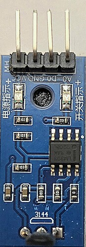

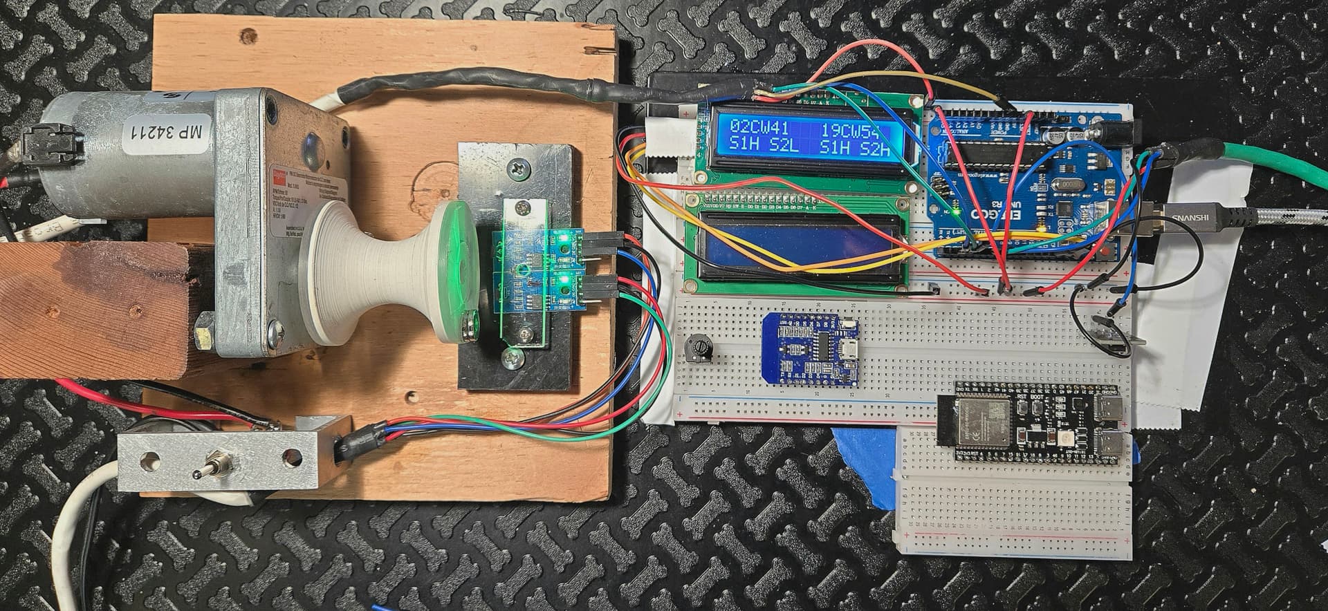

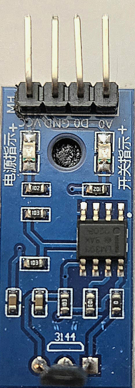

I am just now getting back to this thread I started quite awhile ago. I got hurt and am on crutches so had to put this aside. I did make some progress and got my duel digital hall effect sensors to read counts and direction of rotor so it could give a total sum of increments/decrements for rotation. But did this on Uno. Shifted from LCD to LCD I2C and then to a 2.42 OLED and was getting output to OLED but then it died. I decided it made sense to take sensor data from two rotor units, combine in ESP2866 and try WiFi it to phone. Got simple text through but too complicated. I am a novice and admit I used AI a lot to get basic sketch. I decided ESP32 S3 would be easier using bluetooth than setting up wifi network for this simple twoway connection.
Problem I'm having is since changed to ESP32 S3 I cant get any displays to work on it. I tried my LCD I2C and kept giving errors. Then just wired up standard LCD1602 and cant get it to work. I can get simple Hello World sketch to compile without error but never any output to display. I could try to use my replacement 2.42 OLED but its a bit pricey and dont intend to use it once get output to phone hopefully.
I have tested the LCD standard and I2C on Arduino Uno and both work so displays not deffective.
Any suggestions would be appreciated

I had proper rotational data output from Arduino Uno Rev3 to OLED 2.42 but then display stopped working so I decided to by pass arduino and input sensors directly to ESP2866 to directly WiFi to cellphone. At that point data from two rotors displayed on LCD I2C. But WiFi connection cumbersome and didn't work well so changed to to ESP32 S3 to use bluetooth to phone. But I simply cannot get ESP32 S3 to output to either LCD 1602 or LCD I2C2. Even simple Hello, World doesn't work with nothing else on the board. Once display works I think I will need help with sketch to bluetooth to phone.

You did not really explain what problem you have making it work with an ESP32-S3
So it might be a compiler-problem
reading time 3 - 5 minutes
I guess this is not the best way.
It seems you want to test reading in values and do the test by showinng these values on a display.
Avoid adding another component like a display by simply printing the values to the serial monitor. For testing if the reading in works printing to the serial monitor is sufficient.
For sending the values to a smartphone you can use the library ESPUI which creates a small website that will show your values.

Rotor: I am currently using two prototypes for testing. One is just a small motor with a rotating pulley that has a neodymium disc magnate (9mm x 3mm) glued to the circular face. The magnets pass two Unnamed Hall Effect Sensor Modules that use A3141 chipset. The larger rotor is a life-sized rotor removed from a broken downrigger that I turn with a rechargeable hand drill. It has the same sensor modules.
Display: A 1602 I2C generic display that has no potentiometer.
Microprocessor: Arduino Uno Rev3
HALL EFFECT SENSORS: I am using cheap modules bought on Amazon. I don’t have data sheet but they incorporate the 3144E switch type sensor. The data sheet for this is attached. I also bought some KY-024 Linear Magnetic Hall Effect Sensor Modules which use the same sensor but incorporate a potentiometer which I thought might be useful if problems stemmed from strength of magnetic field. But I never used as connecting wires of sensors were bent up.
Wiring: The two sensors on the small rotor unit are attached by 6 wires.
  • The GND and VCC from all sensors are each combined and attached to the ground and 5 v pins of the Arduino.
  • The DO sensor wires from the small rotor are attached to pins 2 and 3 of the Arduino.
  • The DO sensor wires of the large rotor go to pins 6 and 7 of the Arduino.
  • A Reset push button to GND is connected to pin 4
Rotational Frequency: The small rotor turns at a fixed rate of about 60 rpm. The Large rotor rate is highly variable, as it is controlled by a heavy-duty cordless hand drill attached to the spindle from below. The real unit rotates from barely turning to a maximum of about 480 rpm. (It went from 0-100 rotations in about 13 seconds.)
POWER SUPPLY: The prototype is powered by the USB B cable. The rotors and microprocessors will be powered by two large 12 volt AGM batteries (60 + 80 amp hour capacity) or possibly by two 12 volt, LiFePO4, 105 amp hour batteries. I have not yet considered which way I will reduce voltage to 5v or 3.3v. The cell phone will be charged normally by a USB 3 cable from a 12 volt adapter. It can be on batteries if mobility is required.

  • Schematic of Bidirectional Rotor Counter
  • 3144 Hall Effect Sensor Data Sheet
  • KY-024 Data Sheet
  • Pictures the generic 3144 Sensor and the KY-024
  • Picture of Rotors and Setup

You seem to write to the EEPROM very very often.
Are you aware of that the EEPROM will be worn out after 100 000 writecycles?
If you want to want to do 10^12 writings use a FRAM-module
Displaying
10CCW11____02CCW21
S1L S2H______S3H S4L
is not a selfpurpose
I would like to know what the finale purpose of displaying such numbers is
