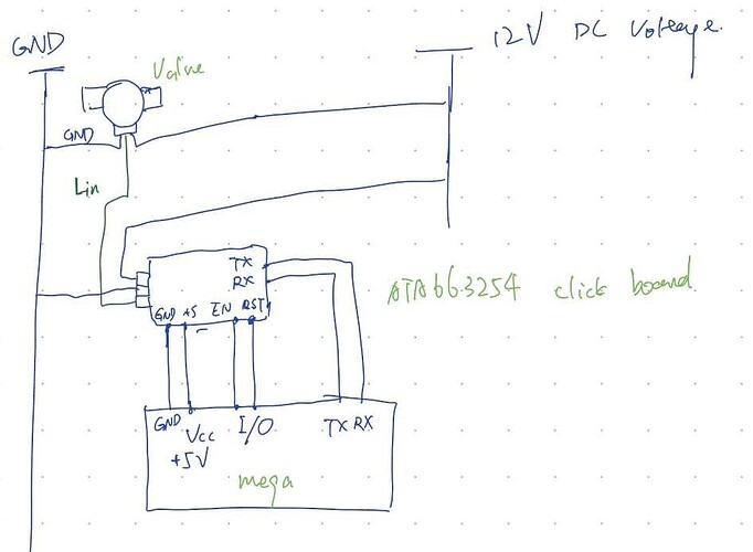

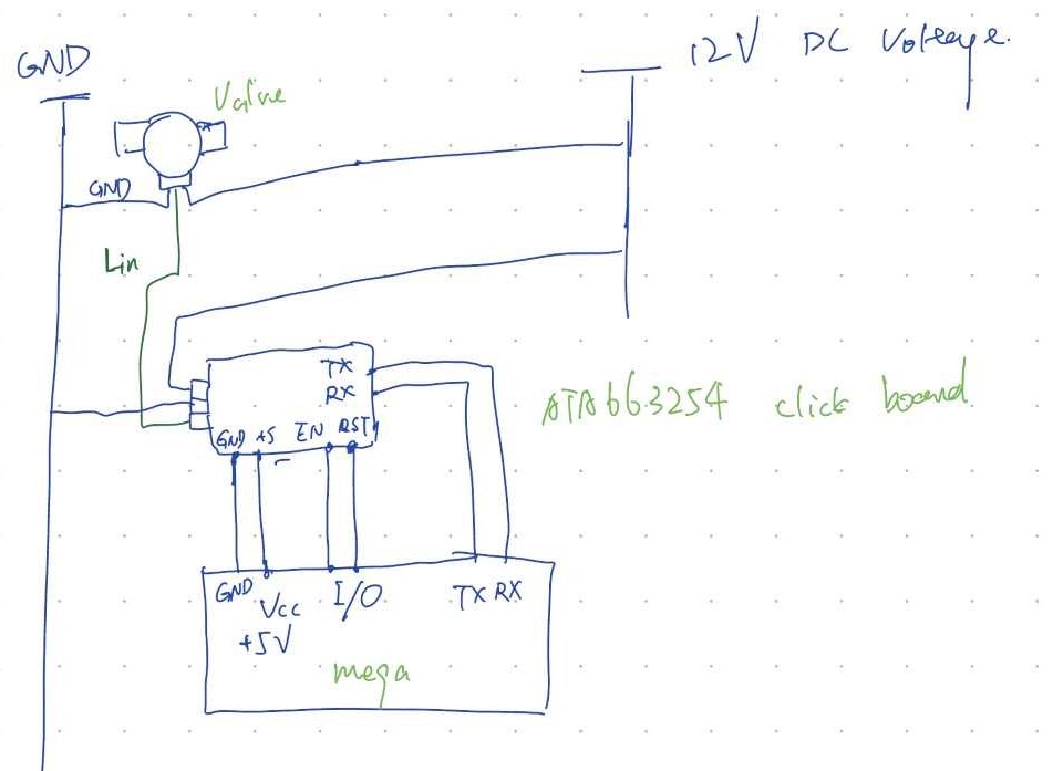

I have found a click board that can replace the mcp2003b chip, the ATA663254 click board. And now i connected this one with my valve.
This is the datasheet of the ATA663254
and the schematic of it. So this time i'm preetty positive that i made it right.

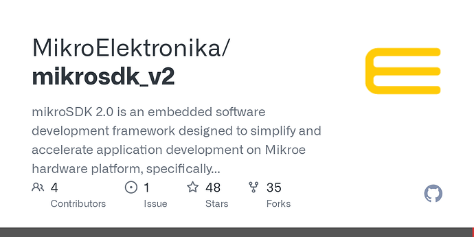

Then this is the libraries that required to use the click board.
And this is my code right now.

Now the problem is: 1. if i use this new library to send the message, should i add the code manually to send first the sync break byte and message ID byte then the buf? Or i can still use the lin library to send my message?
2. It's always 'No such file ' about the the library mikrosdk_v2. I have post another topic about this and have so far no answer. this is the link.
I would really appreciate your help!
