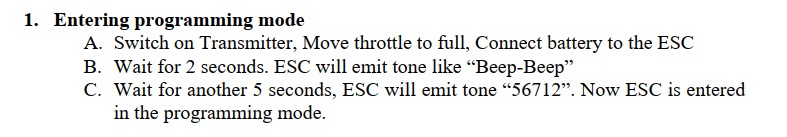

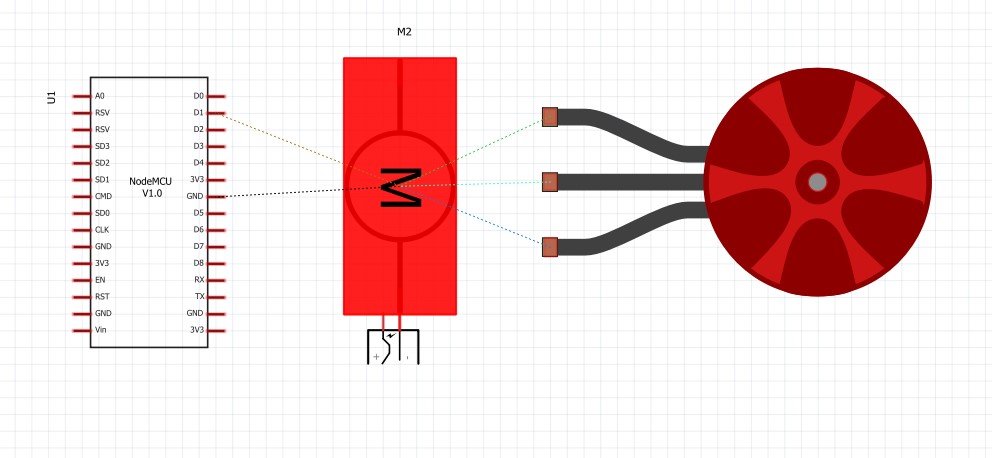

I'd like to use the Power Supply Unit (PSU) instead of battery to control the BLDC motor through ESC with the below configurations:
- ESP8266 NodeMCU 1.0
- PSU (Model S-60-12; AC Input: 220V; DC Input: 12V 5A)
- BLCD: 2212/10T/1400KV
- ESC 30A
Connections like the photo (Servo connector: GND to ESP8266 GND, Throttle Input Pin to ESP8266 D1)
And this is my code:
