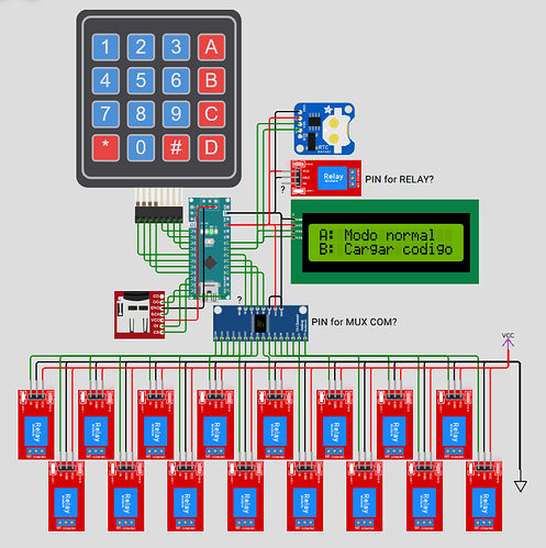

Good morning, it is a pleasure for me to be part of this community.
I am developing a cabinet with 12 electric locks, with a LCD display with I2C, whose access is done through a 4x4 keypad and a 4 digit user code assigned to a person. Then you are asked to choose the door you want to open from 1 to 12 and the selected relay is activated.
All this is registered in a microSD, thanks to a SD module and a DS3231 clock.
I have a problem that I can't solve. I bought a 16 relay module from aliexpress. When I start the program, let me enter the code, validate it and choose the door, at this point, the multiplexer cd74hc4067 does not activate the relay I select, the relay board does not respond, I do not know if it is a connection fault or what happens. I control all this with an arduino nano. The relay board has the 16 inputs, 2 VCC and 2 GND and two more connectors, DC+ and DC-. I leave the code in case I am making a mistake. Even if I measure the voltage between GND and the SIG pin of the multiplexer, I get 4,7V. However, if I test relay board and multiplexer separately, it works correctly.
Thank you in advance for your attention.

Do not start multiple topics with the same subject. Chose one, remove the other.
Hi, @sr_tijera
Have you got some simple code that proves you have control of the multiplexer?
If you wrote your code in stages, you should have this simple code.
Thanks... Tom.... :smiley: :+1: :coffee: :australia:
Connection Diagram:
  1. Connection of the Matrix Keyboard (4x4):
R1 → Pin D6 of the Arduino Nano
R2 → Pin D7 of the Arduino Nano

  1. Multiplexer connection (for 12 gates):
S0 → Pin A0 of the Arduino Nano
S1 → Pin A1 of the Arduino Nano
S2 → Pin A2 of the Arduino Nano
S3 → Pin A3 of the Arduino Nano
COM_PIN (Control) → Pin D2 (you can choose any control pin to open the relay, but make sure it does not interfere with other components)
  1. Relay Board Connection:
IN1 - IN16 (for 16 relays) → Connect them to the Arduino control pins (you can use 16 available GPIO pins like D0, D1, D3... D12).
VCC → 5V from the Arduino Nano
GND → GND from the Arduino Nano
Sorry, a picture/schematic is worth a thousand words.
Have you got a simple test code?
You copy/pasted a few sketches, poorly ([edit] but it still compiles and "works" what's the combo stored in EEPROM?). Here, you are using pins for multiple devices. And you never declare pins for the mux. Send it back to chatGPT or dump it and start with controlling one device and add to it.
Did you delete your other topic with the same subject?
diagram.json for wokwi.com

You must connect Pin 15 INHIBIT to GND.
The EEPROM option is for storing 25 or 40 user codes.
The EN pin of the mux is connected to GND, yet the relay board is not connected at any time.
If I connect the D2 pin to the keypad and the SIG pin of the mux, can there be errors?
Probably. D2 is OUTPUT for Keypad. What do you expect the mux to do with a keypad entry, or what do you expect Arduino to do with SIG/COM of the mux?
Yes, I fixed MY oversight. Remember, this is your project. You need to make a (flawless?) drawing and stop trying to find minor details of my drawing.
I am not looking for errors, you have asked me about the EN pin and I have answered, I have it connected to GND. I am making a schematic in the FRITZING app, as soon as I have it, I will share it with you.
I have had the SIG pin connected to A6, A7 and even D8 and it doesn't work.
No, I did not.
Provide drawings and code with the initial question.
Probably not when you connect the keypad pins to the sig/com.
I used @xfpd hardware and the code from #1, which I asked chatGPT to translate into English.
The wokwi server is slammed, so no playing with it.
Should the relays be active LOW or active HIGH? wokwi lets you chose, the default is active HIGH.
I don't see any code addressing addressing a particular relay...

OK I got some run time in using @xfpd's technique.
Reminder: pins A6 and A7 are analog only.
I say because I looked and saw a need to use another output pin because 8 is used for the keypad in the original code.
Am I wrong or are you out of pins?

Buenas noches, voy a proceder a escribir en español.
He decidido usar un multiplexor, el pin SIG es el pin que manda la señal de accionamiento al relé solicitado. Estoy usando una placa de 16 relés, de aliexpress, mi problema es que no se activa ningún relé, es más, tiene algo que ver la alimentación externa?
Un saludo, Cualquier duda que tengáis, por favor decírmelo. Si alguien se ha sentido ofendido, pido disculpas, es el primer post que hago y estoy aprendiendo, por eso os pido ayuda.
Gracias a todos.
Es posible que al quedarme sin pines, no tenga donde conectarlo?
Si en los pines A6, A7 no puedo, no tengo más pines libres
Un saludo.
