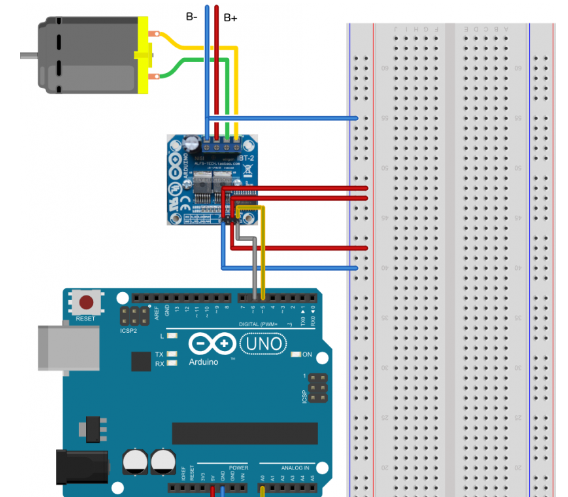

I'm trying to control the speed of a dc motor with MPU6050, IBT-2, and Arduino UNO. This is the code that I'm uploading on Arduino. The motor doesn't even start when i turn the power on. What's wrong with the code, any idea?

Show us at lease a block diagram of how you have all this connected. I hope you are not trying to POWER the motor using your Arduino! What are the electrical specifications for your motor?
A schematic would be great.
A few images of your project can also help.

This is the connection. Nothing is attached to A0 please ignore that.
MPU6050 connection with Arduino:
SCL - A5
SDA - A4
VCC - 5V of Arduino
GND - GND of arduino
I'm using a dc power supply to power the motor with 12V.
Could it be a problem with the IMU sensor? I checked it with a separate program, it was giving roll pitch values but everytime it suddenly stops giving values after half a min or so. But it does give values in the beginning.
there is no problem with the motor or power supply. I've made several other projects with these and they've worked fine. The motor is working fine when i connect it directly to the supply.
