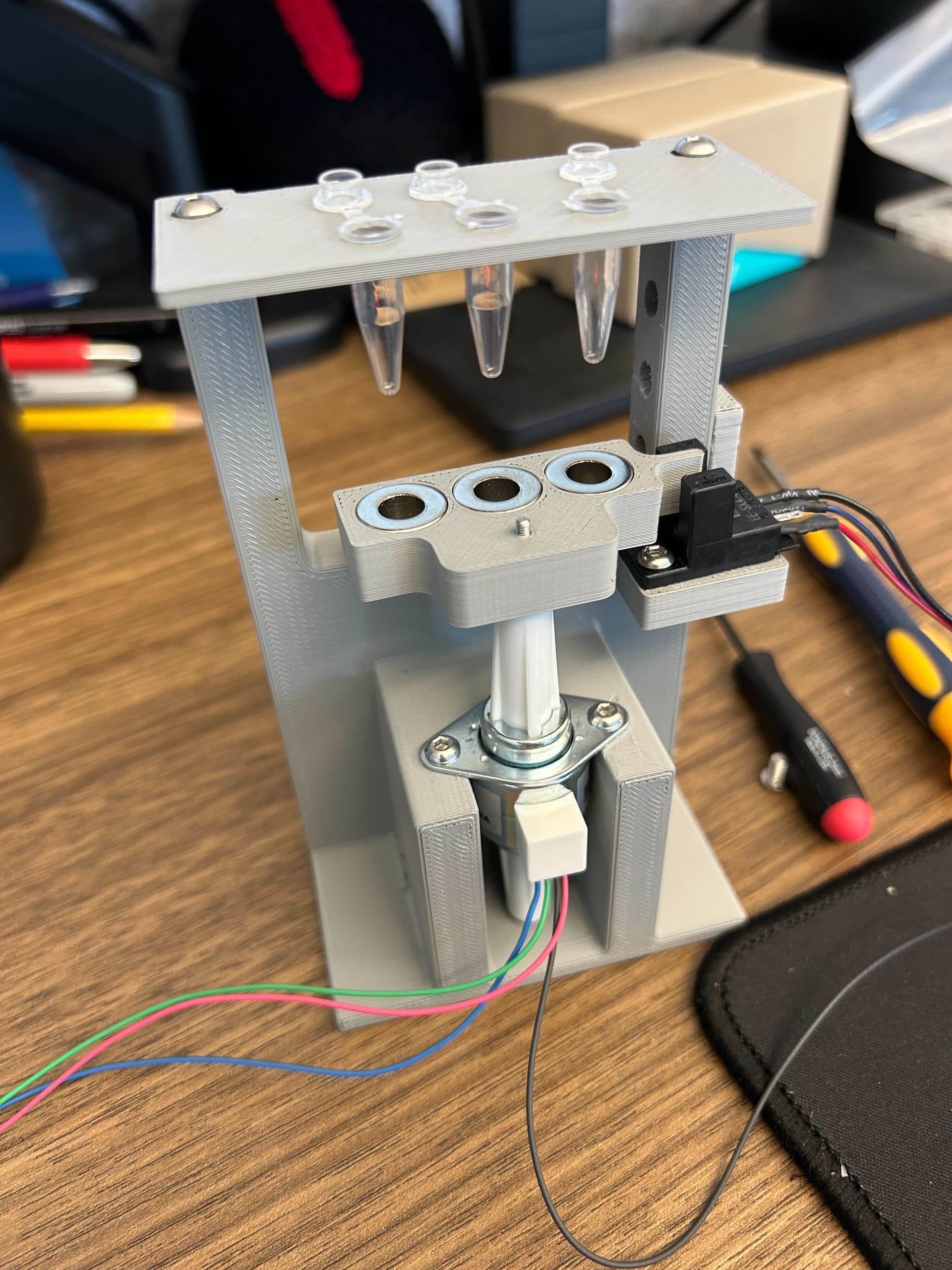

I am try to make a little breadboard setup to test out a linear can stack motor for an application I am working on. I want to be able to control the motor based off a home sensor and I am planning on using an omron optical sensor
I am trying to use a MEGA2560 with a ULN2003 Stepper Motors and Motor Driver Boards.
I have figured out my first issue which was how to get power to the linear can stack motor. The connector only has 4 wires out so I need to bring in v+ through a parallel circuit with the phase pair wires. This "should" get the motor up and running but need to build the circuit and try it out.

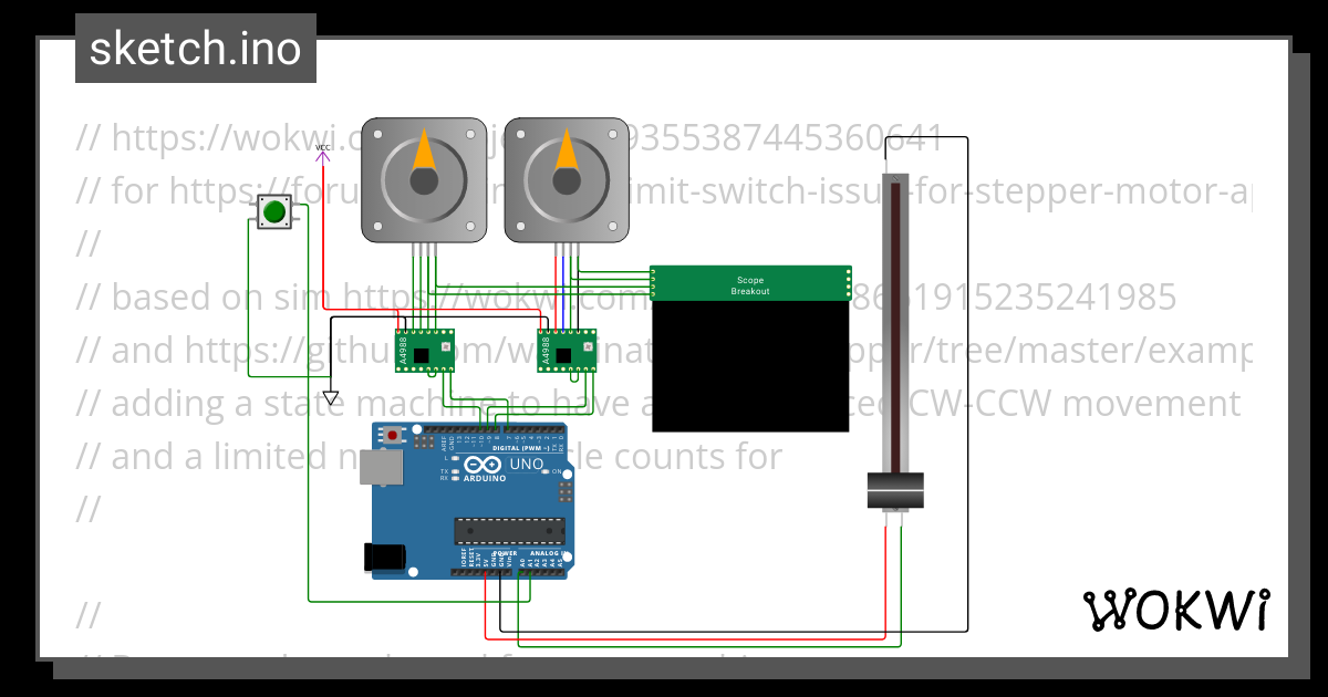

The stepper.h library is a terrible choice if you want to also be looking at a limit switch. While it is executing a myStepper.set(stepsPerRevolution) it cannot notice if it triggered the limit switch.
Maybe start with a non-blocking library like AccelStepper.h or MobaTools.
Here's a sloppy simulation of AccelStepper moving a stepper with a physical and simulated limit switches.

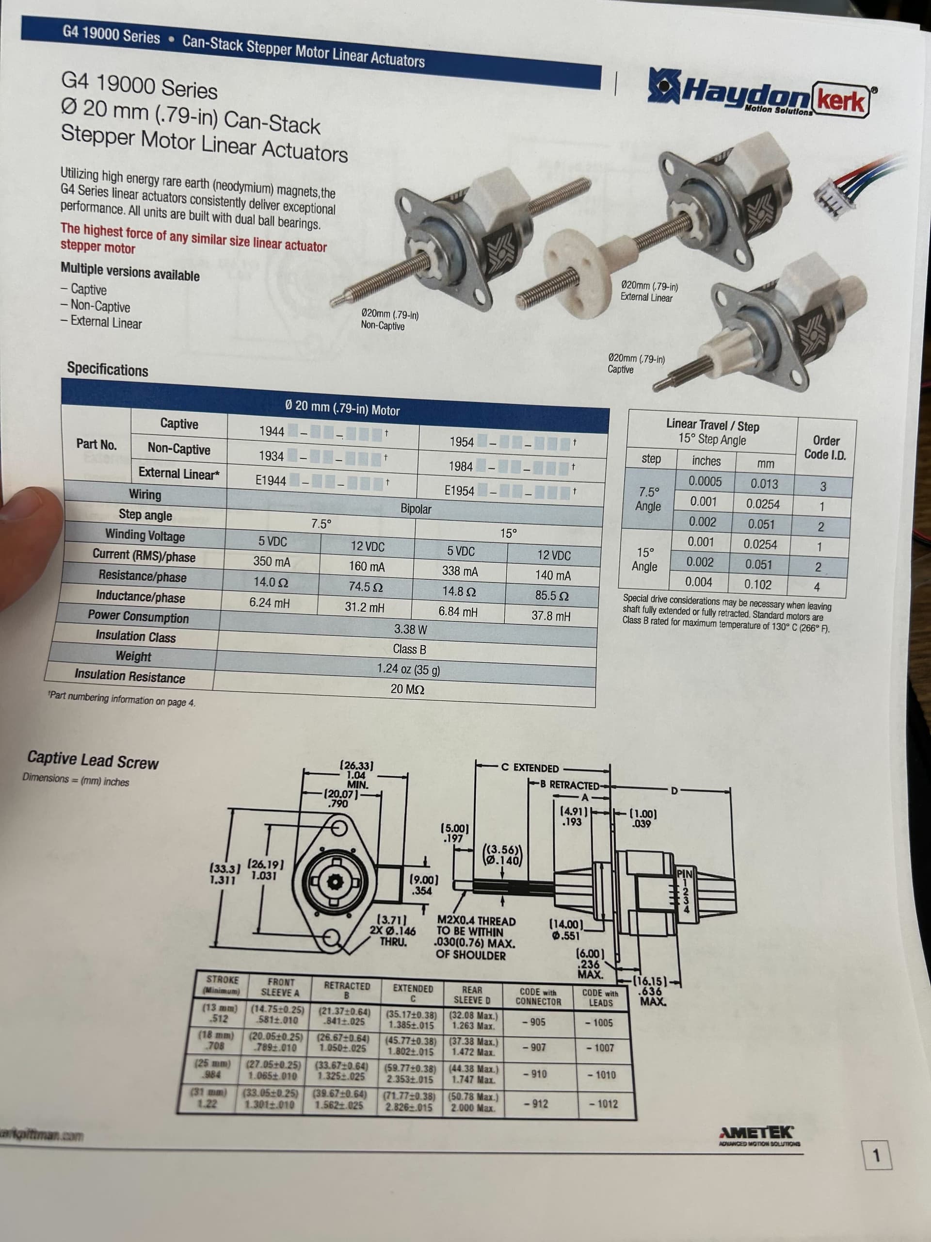

A ULN2003 cannot drive a bipolar motor.
The stepper in your link and the stepper in your picture are totally different. You cannot use the ULN2003 to drive the bipolar motor in your picture. The ULN can only be used for unipolar steppers.
Which of the motors in that datasheet do you use?

I intend to use the linear can stepper motor. I added the other link because that is the controller I have on hand but looks like it won't work. Sounds like the A4988 will work with a bipolar according to JCA34F
The A4988 is designed to work with low impedance steppers. Your stepper looks like a high impedance stepper. Du you have the 5V or 12V version? The 5V version may work with an A4988 and a Vmot of at least 12V.
These steppers have a fairly high angle per step. Microstepping usually doesn't work well with those steppers. I think a simple H-bridge may work well.
I have the 5v version of the motor. Do you think the A4988 will work with the 5V?
With at least 12V and correct current setting it should work.

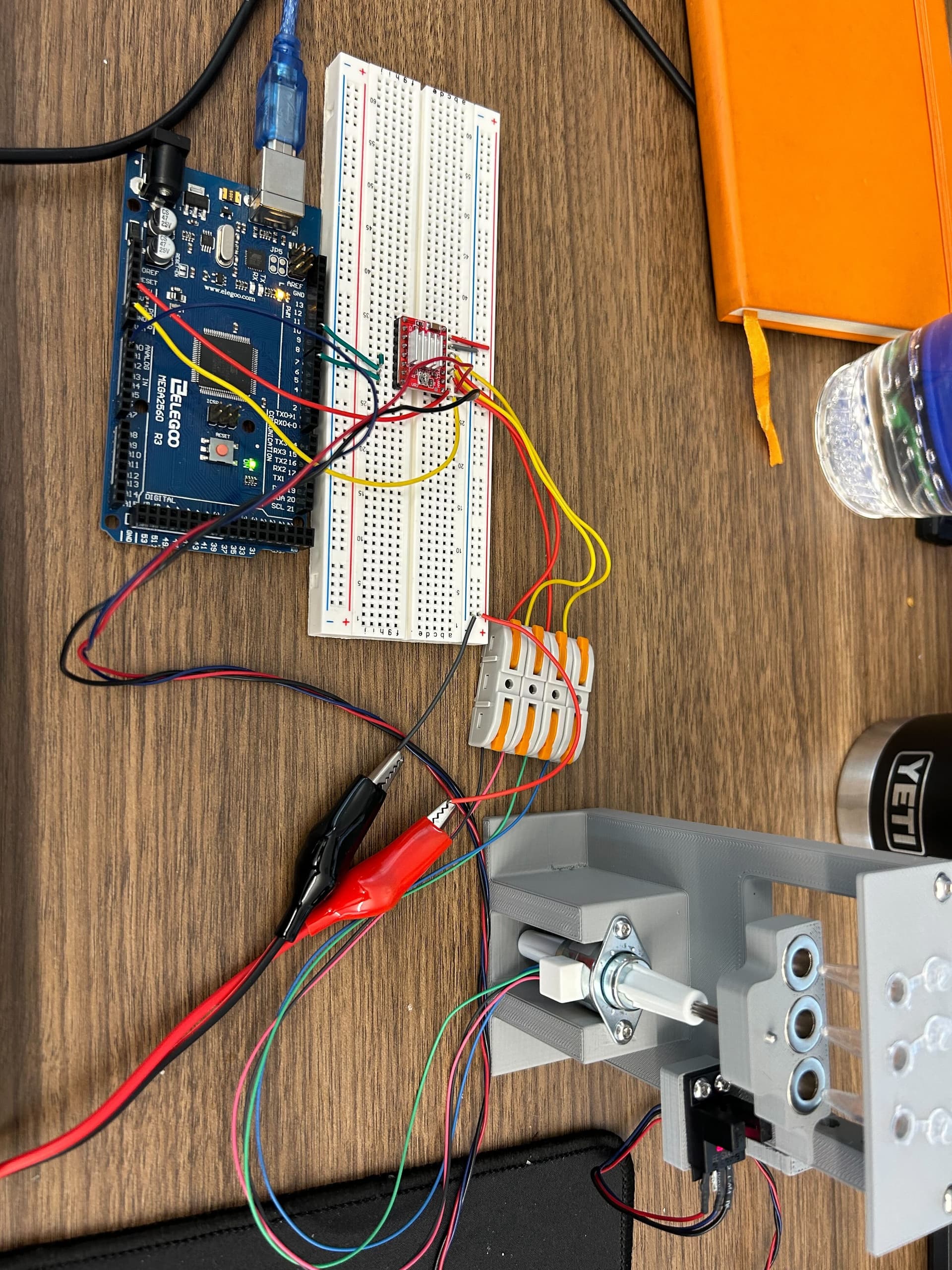

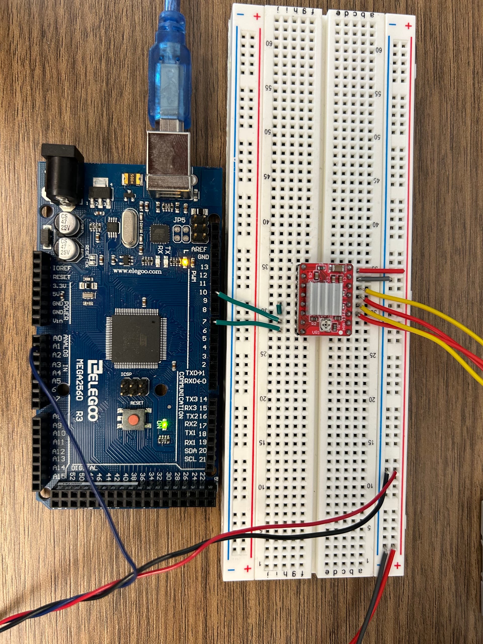

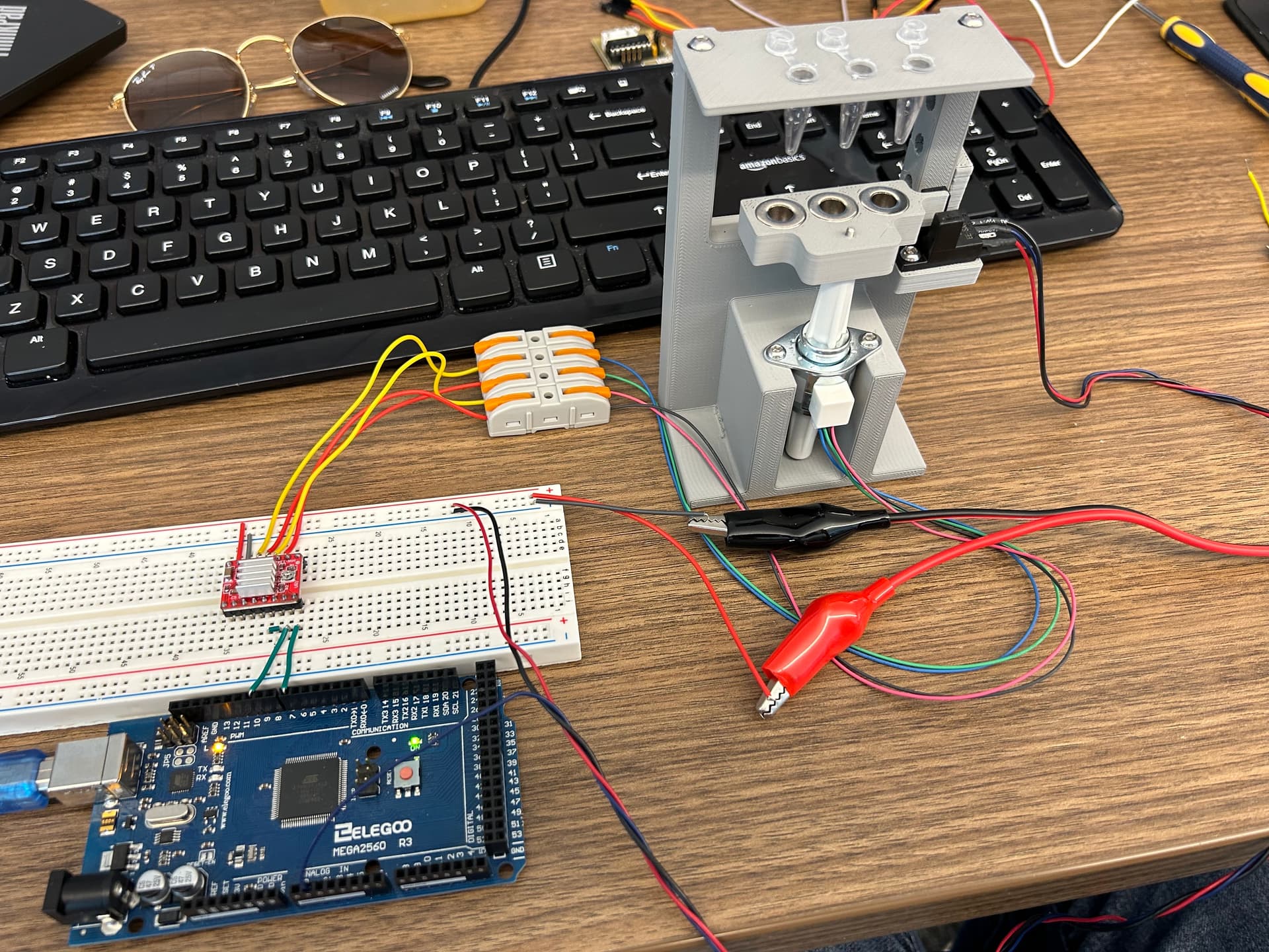

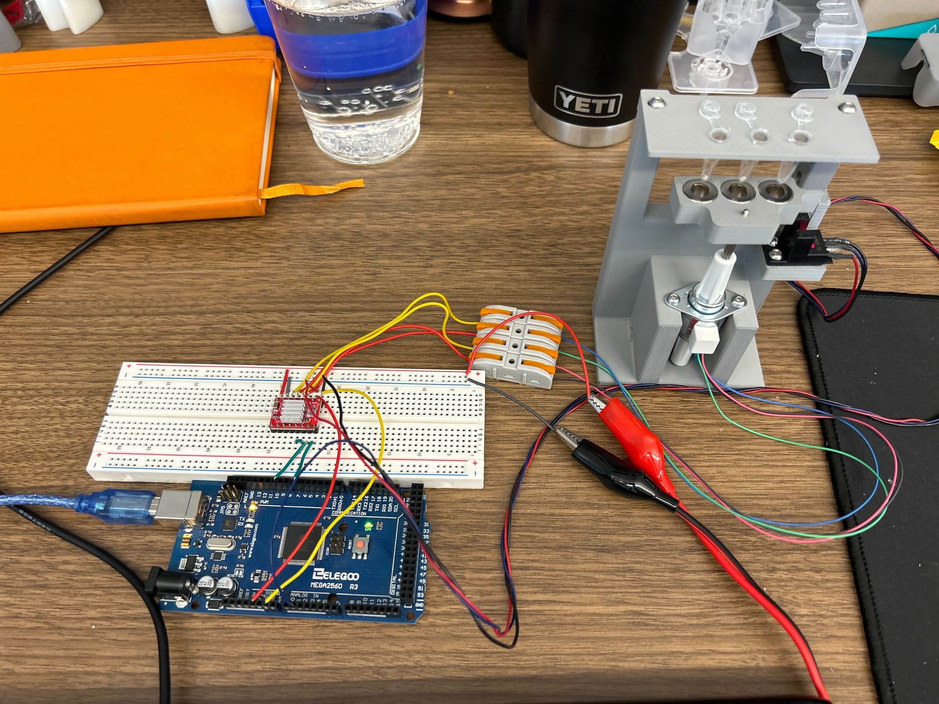

Hey DaveX. Thanks for the diagram for wiring and code. I have since sourced some 4988 controllers and have wire up a breadboard (see photos). I have an externa power supply hooked up at 12V and 0.34a. However I am still struggling to get the motor to move even with just absolute moves. I tried writing another code base to try and get it to move. Could you take a look at my code an give me some pointers?

Is it a problem with the parsing or is it a problem with the motion?

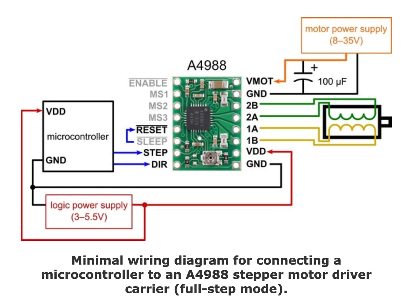

In the pic it is unclear if there's a signal ground from the Mega to the driver. Pololu says:
Success! Thanks for all the help everyone! Getting some power to the A4988 was a great idea @DaveX :sweat_smile: . I got my motor moving and fully functional with an initialization homing procedure and can input distance I want to move in mm and the direction!
