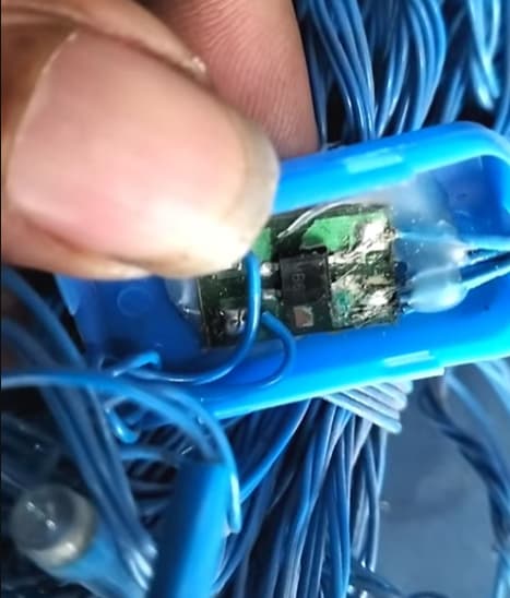

I want to control LED rice lights (series config) with arduino using PWM function. I know that low voltage DC it's possible but can we do it with serial string lights at 220VAC?
I searched in the internet and they say one can use a relay or a triac but these can only switch them on and off instead of using analog PWM fading function.
Is it possible to fading of breathing program for mains voltage rice lights?
Edit: I have a full bridge rectifier in series before the mains plug

It came with the product. I guess to make it DC maybe. Most of the LED rice lights comes with that bridge rectifier.
Edit: Photo

This look okay. The author says " zero cross detection circuit and trigger circuits for triac to achieve this effect."
There are some dimmer boards I seen on Amazon and Alibaba but I have never used one.
