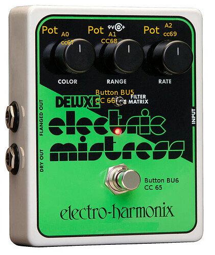

Hello!
Imagine this config for one pedal on amplitube or guitar rig
How Could i build one "CC change button" for change CC on this three pots and two buttons?
For example:
I press the button and now the pots are changing CC...now the pots are : 70 , 71 and 72 respectively (before pressing the button the pots was 67, 68 and 69).
And the same for the buttons..before pressing the "CC change button" was 65 and 66...and now i press the button and the buttons change to 70 and 71.
I am trying to understand how could i use your library and use the info,
I see one example on arduino about changing channel with rotary encoder..
and i have tried to modified no success..
Do you think it´s mad using midi.h controller.h and controlsurface.h ...all libraries in the same sketch?? (
I am on early stages right now but i think its the best option for me.. this works well for me at this moment..

chichiforever:
I wouldn't recommend it, they might interfere in unexpected ways.
It looks like you're only using two buttons of the Controller.h library. If I understand the code and comments correctly, these can very easily be replaced by the following Control Surface equivalent:
CCButtonLatched buttons[] {
  {5, 66},
  {6, 67},
Control Surface doesn't care what kind of pins you use, you don't have to do anything special to make this work with a multiplexer, for example, simply replace the pins:
  {mux.pin(0), 66},
  {mux.pin(1), 67},

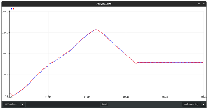

I've done some tests comparing the Controller.h potentiometer performance with Control Surface and I'm unable to reproduce this. In the absence of noise, they both perform almost identically, in the presence of noise, Control Surface outperforms the Controller.h code.
The red line is Controller.h, the blue line is Control Surface. As you can see, Control Surface does a better job of filtering out the noise. On the right side of the graph, the potentiometer didn't move, but Controller.h still thought it was moving due to noise on the analog input.
If you have more noise than before, it's a good idea to check your hardware and wiring. Did you solder the potentiometers or are you using a breadboard and jumper wires? Jumper wires don't always give the best connections.
Yes that´s true i see the two lines on your graph they are almost the same..
Certainly.. i was full of noise problems one week ago, and this it´s noticeable on midi.h and controller.h.
Theres so much more noise on midi.h and controller.h..this its absolutely true on my case..control surface works pretty well about the noise..
The noise comes on +5 volts and ground wires..you must be careful about this problem when you wire up.
But now for me works pretty well. no protoboards and i think i got correct wiring and soldering.
If you have noise problems you will see the ghost midi signals on your DAW...makes everything so much more complicated.
But my problem was moving potentiometers..i think there was more performed movement for the pots before....
moving the pot, when i reach the end ... or moving to zero.. i see strange things happens! i see this on the amplitube screen pot.
