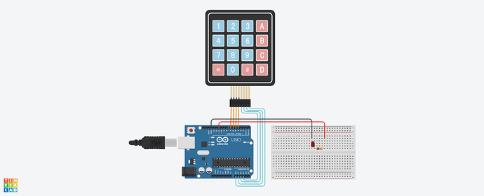

I am creating an Arduino sketch that uses a keypad to define the approximated output analog voltage that will light the LED connected to the Arduino on pin 11. This means that by entering a three-digit number into the keypad, you can control the intensity of the LED lighting connected to pin 11 via an Arduino output PWM.
the issue is I am still new and don't know how to make a keypad have more than single input, I have done what I can from what I read but I am stuck
