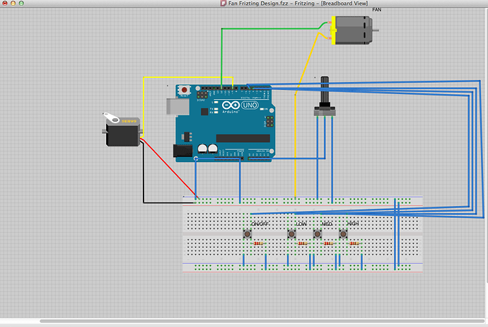

Sorry for the confusion, I forgot to add that I am actually also controlling a servo with a pot. I'll attach my fritizing sketch so you can see what i've done so far, however I am not completely finished. I will also post what I am trying to fulfil so you have more understanding on what I am trying to create here.
Fan Control Deluxe:
  • Use an H-Bridge to control the speed (and optionally the direction) of a fan motor.
  • The motor is mounted on a servo to control direction of fan.
  • Two pushbuttons (+/-) or one potentiometer control the speed of the fan.
  • Two pushbuttons (left/right) or one potentiometer control the servo and with it the direction of the fan.
Options:
  • One pushbutton enable/disables left/right fan oscillation.
  • Two thermistors mounted at some distance of the fan measure the temperature and automaticallyt direct the fan to the hottest of these two spots.
  • Three buttons for direct setting of off/medium/full speed.
  • A Processing program displays a GUI to remotely control the fan operation.
There are a few things I obviously haven't done yet (For example added in my H-bridge) but this is just because I am trying to get everything to work before I move onto that step. I am still relatively new to Arduino.
Thanks guys :slight_smile:
Hi, (after recovering from 5minutes in fetal position from looking at fritz.)
Forget trying to power the servo from the arduino, it cannot supply enough current.
Forget about powering the motor from the arduino for the same reason.
I suggest you start from scratch and just program to get the motor control working.
Then start from scratch get the servo working.
Then put it together.
Now please a circuit diagram, full one just the motor , forget the servo for now.
Do it in anything except Fritz, hand draw and photograph if you like.
What is the DC Brushless Fan, because of the way they work, I doubt you will be able to reliably control its speed by controlling its power supply.
