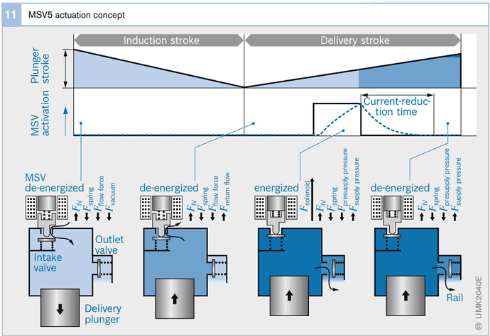

I'm working on my final project for my bachelor's degree automotive technology and I need to put a standalone ECU on a Audi A1 1.4TFSI. a student last year did the install and first configuration of the ECU and stumbled on a problem: the high pressure fuel pump has a normally closed spill valve instead of a normally open spill valve. A picture of the difference in signal is shown below (longest signal being normally closed):
This means that the ECU sends out the shortest signal.
The previous student had contact with the engineers at Link and they said it couldn’t be done. That’s where I and the Arduino come in to play. So I now need to finish this project and need to find a solution for the pump.
My idea is to take the crankshaft position signal and the pump control signal as my inputs. The crankshaft position signal counts the amount of teeth and resets the signal when TDC comes by so it can count again. This way I can count for example 1 and teeth to start the signal (the start of the signal is always constant in this type of signal). Then I use the pump control signal the end my signal. The pump control signal variates in function of desired pressure, so if I use this signal, the ECU can still calculate the desired fuel pressure and can correct the signal if the pressure is too high or too low.
