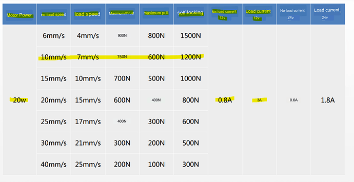

The no load speed of my actuator is 10mm/s and the load speed is 7mm/s........ please can anyone suggest me a solution

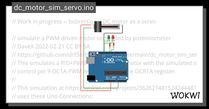

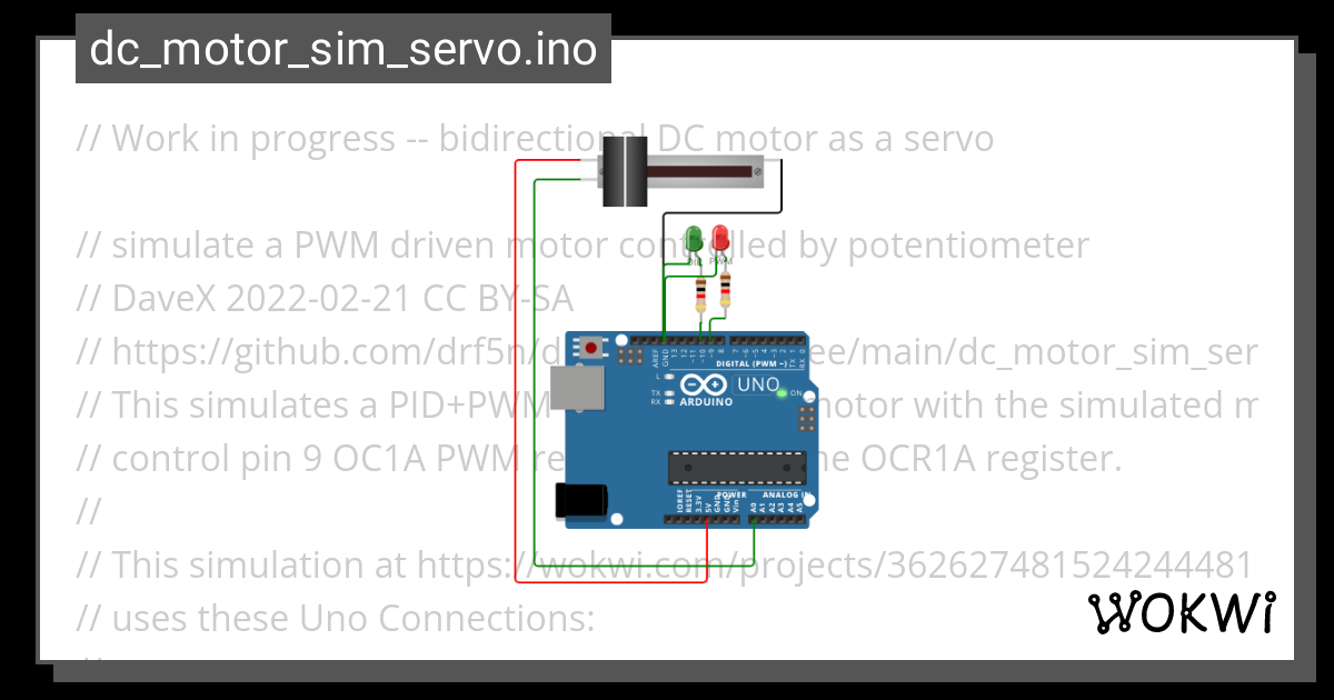

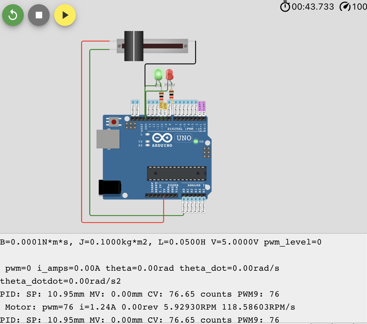

I had an Wokwi simulation simulating the physics of a DC motor, and I edited it a bit to make a simulated servo out of it:
  • The top slider sets the setpoint of the process at 0-100mm
  • The simulated motor drives a simulated linear actuator from 0-100mm, with the simulated process measurements and motor variables measurements printed in the serial monitor
  • The LEDs show the PWM signal and the direction signal that is being fed into the simulated motor.
There are many configurable parameters, from motor inertia and friction, to the translation of turns of the motor into linear distance, and the code is rough and untuned, but it demonstrates the process of making a servo out of a PID controlled DC motor with an analog distance sensor.
You are welcome to play around with it to see how bi-directional dc motor might move an actuator, how that might move an analog sensor, and how one might use the actuator output to change the motor inputs with a PID.
What I like about this simulation is that the simulated motor gets its inputs through the PWM pin and direction pin.
I think the sim shows a way to do the first and second parts of this suggestion, and the third part would be like simulating sliding the pot at the desired speed.
Your hardware would be different. Good luck.
