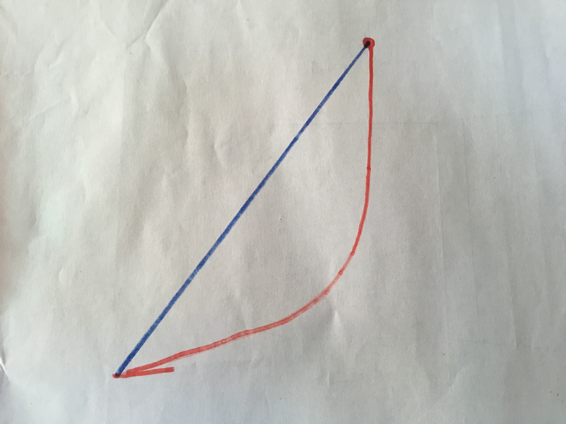

Hi, i”m making a vertical plotter powered by an arduino uno with an Adafruit v1 motor shield. It consists of 2 NEMA 17 stepper motors spaced about 350mm apart. The steppers are connected to a “pen” with a GT2 rubber belt.
I’m currently trying to make it draw a straight line, but since the motors have the same speed and acceleration, the lines are not straight when the amount of steps each motor has to take is different. Currently, the following values define the motors speed and acceleration: stepper1.setMaxSpeed(200); stepper1.setMaxAcceleration(150.0); stepper2.setMaxSpeed(200); stepper2.setMaxAcceleration(150);
Eventually, i want a function that takes a distance and angle. and moves the steppers to that position.
Any help on this would be greatly appreciated.
(below in red: the line the plotter has drawn, in blue: the line i want the plotter to draw)

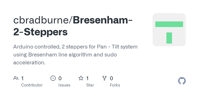

For synchronised 2D-motion you can use the Bresenham-algorithm.
this might be interesting too

I had to ask Google what a polargraph is and he said it was drawing based on POLAR coordinates, not rectangular coordinates. What do you think a straight line is in polar coordinates? It is a curved line like when you fly from NewYork to Honolulu, you fly a curve.
So likely your red line is a correct straight line if you convert back to rectangular coordinates.

So far you have only shown a picture of the drawing result you got with your actual code.
You haven't explained how your mechanic is working. Best thing would be to post a picture how your mechanic looks like.
I estimate your mechanic is XY-axles and then the easiest way to get controlled motion is to use the bresenham algorithm.
You wrote
If the two motors have a different number of steps to do the speeds are different!!.
If you want to have a straight line the ratio how many steps in X-direction and how many steps in Y-direction has to be constant. dY / dx has to be constant.
If you use acceleration the acceleration-phase can be different long and this causes the effect you see on the paper: a curved line.
If you disable acceleration this might work more or less. Because by disabling acceleration the speed-ratio dY / dX stays the same from the very first step to the very last step.
The stepper-motors have to be kept in sync for a straight line. Regardless of the straight-lines direction. Even for vertical lines or horizontal lines the two stepper-motors have t be kept in sync.
For a vertical line keep X-motor at speed zero for all Y-steps (= they are synchronised to each other
unsynchronised would mean at some y-steps x-steps are zero and at other y-steps x-steps are non-zero. That would be out of synchronisation
And the only way to keep the two axles in sync is to create the step-pulses of both axles inside **one single ** loop.
And that is what the bresenham algorithm is doing. If you use the bresenham-algorithm you can use acceleration because the timing changes always in synchronisation for both axles.

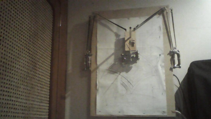

This is a picture of my current setup.
(Separate messages because I can only post one image per message.)
The same in pygame simulation of my plotter (I use this for testing).
As seen in the top picture, the movement of the pen relies on the use of weights. So without acceleration, every time the plotter suddenly stops, the weight swings a bit causing a slight offset from the target position. I'm not familiar with controlling steppers in this way, and also not familiar enough with mathematics to figure out the conversions from a cartesian plane to polar coordinates to synchronized stepper motion.

Now you have a very different mechanical system.
If you don't have a ready to use project there is no way around doing the calculations from cartesian xy-coordinates to changing toothbelt-lengths
