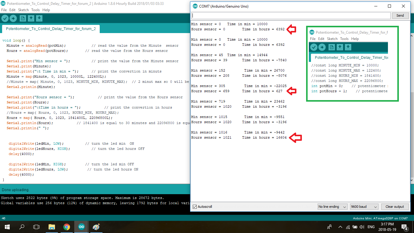

I be leave I did program both way like it should. But got result witch seam not right. You can see the pictures.
MINUTE_MIN Work fine giving me 10000;
Both HOURS_MIN give me 6392 and should give me 1841400 ( -xxxxx ).
INLINE DECLARATION

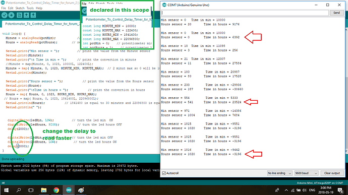

DECLAIRE IN THE SCOPE
const long MINUTE_MIN = 10000;
const long MINUTE_MAX = 122400;
const long HOURS_MIN = 1841400;
const long HOURS_MAX = 22096800;

Instead of:
int Minute = 0;    // variable to store the value coming from the sensor
int Hours = 0;    // variable to store the value coming from the sensor
Try:
long Minute = 0;    // variable to store the value coming from the sensor
long Hours = 0;    // variable to store the value coming from the sensor
Thanks Outsider
It did almost fix it totally but the HOURS_MAX = 22,096,800 is still bad.
And if you read ''long int''
It should go up to 2,147,483,647.
I posted a Print-screen whit the result.
