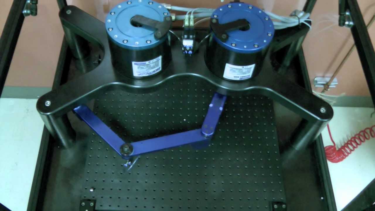

Does anyone have any suggestions on how to control the position of the servo? I can adjust the speed and direction but it just rotates in the same direction over and over again. I understand continuous rotation servos lack position feedback but there has to be some way to achieve position control. Any help would be greatly appreciated!
This is the project I am trying to accomplish:

Right now, I'm trying to move two connected arms around a workspace (just like the youtube video I provided). Each arm is controlled by a servo. Later on down the road I will add end of arm tooling but I'm still working on controlling the servos to move in the direction/speed/position I want. A sail winch servo moves in a continuous motion correct? Could I move to say 127 degrees?
