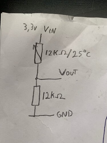

I have built a voltage divider with an NTC that has 12K ohm at 25 degrees C.
The analog input i have on my arduino is 12-bit and the voltage in are 3.3v
I have converted the sensorvalue to voltage in the program.
Code: float voltage = (sensorVal/4096.0) * 3.3;
The problem:
I don't know how to convert the sensorvalue to temperature.
The conversion is sensor resistance to temperature, which depends on which type of thermistor you have.
