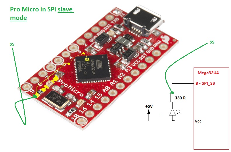

after a lot of googling it seems Pro Micro's and SPI do not work well together. SS is connected to PIN 17 which is not brought out to a pad. instead it is connected to the RX LED. by connecting a wire to the Resistor that feeds the LED (IE the connection straight from the Chip) and setting SS in my code to pin 17 it works!
Your Pro Micro is acting as an SPI master, correct? Because the only time you really need /SS (Slave Select) is when you're using the chip as an SPI slave. As a master, you can use whatever pin you like for your slave's /CS. It's an entirely different thing than /SS.

I did a lot of googling, "Pro Micro SPI" brought up many posts about the issue. 2 post's caught my attention.
this one
https://forums.adafruit.com/viewtopic.php?t=74383
talked about making Pin 17 the SS pin
and this one
which shows attaching a wire to the Board for the SS connection.
for whatever reason, it now works!!!
I am REALLY curious now as I also ordered a couple of Adafruit Itsy Bitsy boards and the schematic for that board shows that the SS pin isn't connected to anything. I might not be able to use those for SPI. eh whatever. I am just happy that I got it to work and I can put the lid on this thing now and be done with it!!!
As I said, you're not using slave mode. /SS is irrelevant. But have it your way, it makes no difference to me.

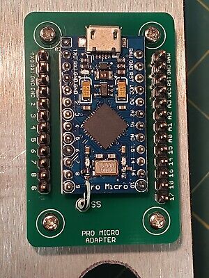

To help others. I have designed and created a Pro Micro Adapter board that serves 2 functions. #1 is a way to mount a pro micro in a project and #2 is to allow you to add a jumper to bring the SPI SS pin 17 out to a header for projects that need it!
