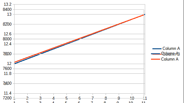

Here are the 0.1 voltage readings from 12.00 to 13.00V Again without the 0X?? in front
Volts  Readings
12.0   08,1E
12.1   48,1E
12.2   88,1E
12.3   C8,1E
12.4   08,1F
12.5   48,1F
12.6   88,1F
12.7   C8,1F
12.8   08,20
12.9   48,20
13.00  88,20
Try by applying the following Scale factor:
0.00156 obtained from data pattern of #10.
byte  rx_frame[] = {0xDD, 0x38, 0xF4, 0xE7, 0x60, 0x48, 0x1F, 0xff};
int rawVolt =  rx_frame[6] << 8 | rx_frame[5]; //0x1F48 = 8008
float psVolt = rawVolt*0.00156; //12.49
Serial.println(psVolt, 2); //12.49 ~= 12.5
The two graphs have a different slope. Some bits went missing. I converted "Readings" to DEC using LSB, MSB
What scale factor do you expect from your curve?
1:1
I have claimed it as 0.00156 in #11.
It helps to convert the hex representation in post #10 to decimal, then fit to a line.
According to the data you collected, there is a small offset and the equation to convert the integer value to volts is
float volts = 0.0016*integer_value - 0.0125;

Looking at the data posted by @jremington,
the difference between 12 and 13 volts is 640
7688 = 12 * 640 + 8
8328 = 13 * 640 + 8
Which leads to an equation for 640 per volt, with an offset of 8:
float volts = (integer_value - 8) / 640.0;
1/640 = 0.0015625. Excel rounds that off to four digits past the decimal point to print 0.0016
