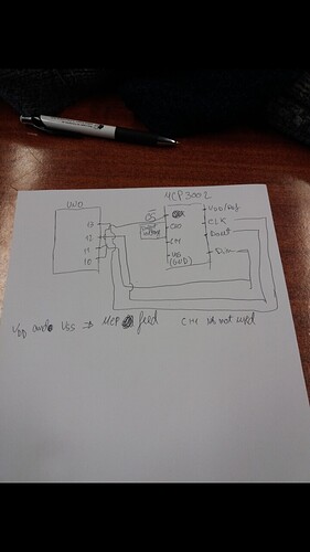

Hello,
I'm using MCP3002 ADC to convert the analog voltage input to digital for arduino but i dont know how to program it.
Can some one help me with programming the arduino to do the converstion.
I have found this code but it reads zero all the way.

I'm using arduino Uno. I dont have the circuit with me but i've drawn a sketch wich i send as a attachment.
OPs diagram;
What is the line you have written under the diagram?
I hope the gnd of the UNO and Vss of the 3002 are connected.
What voltage are you powering th e 3002?
Tom... :slight_smile:
What i wrote was that ch1 is not used and that the VSS and Vdd are the supply contacts. The supply is 5V i think and yes the grounds are connected
