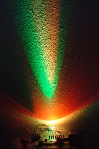

To add to what Lefty correctly told you - in very few cases is it necessary to drive a LED to it's rated current capacity. You will be surprised how bright it can be at a small fraction of that. Most red LEDs are plenty bright enough at 2 or 3 ma or even less.
Only 3 LEDs each at around 6mA in a dark bedroom. 20mA will hurt your eyes if you stare at it.
