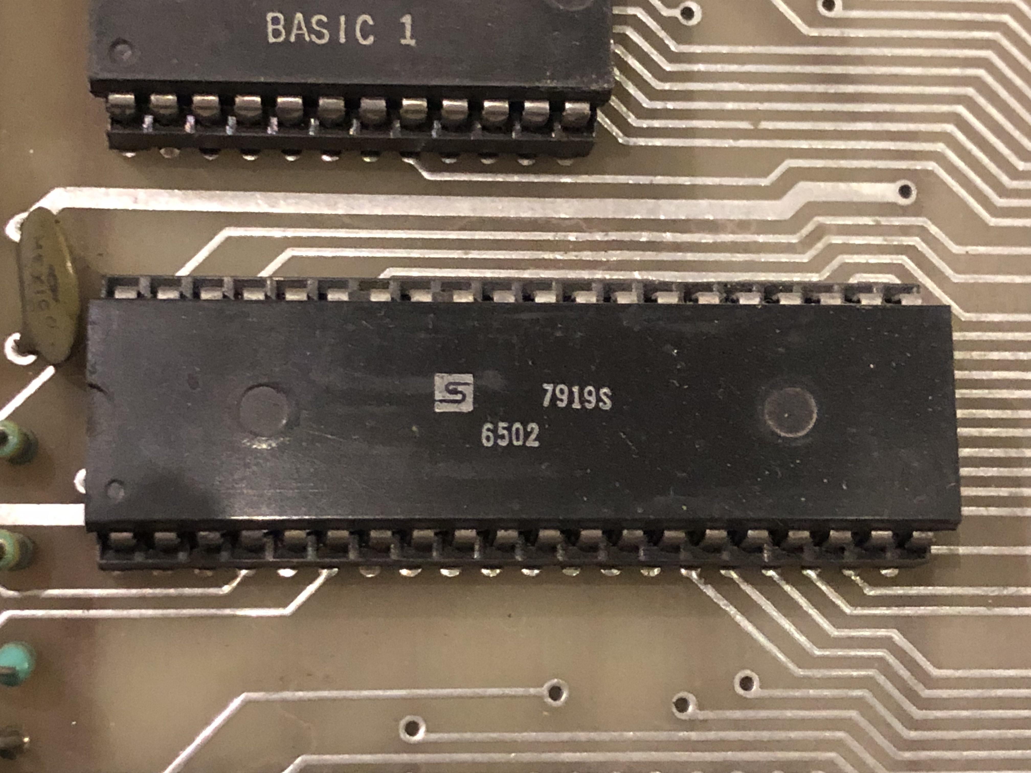

Not to digress, I still have my C1P computer, based on the 6502
Yes, with BASIC in ROM
