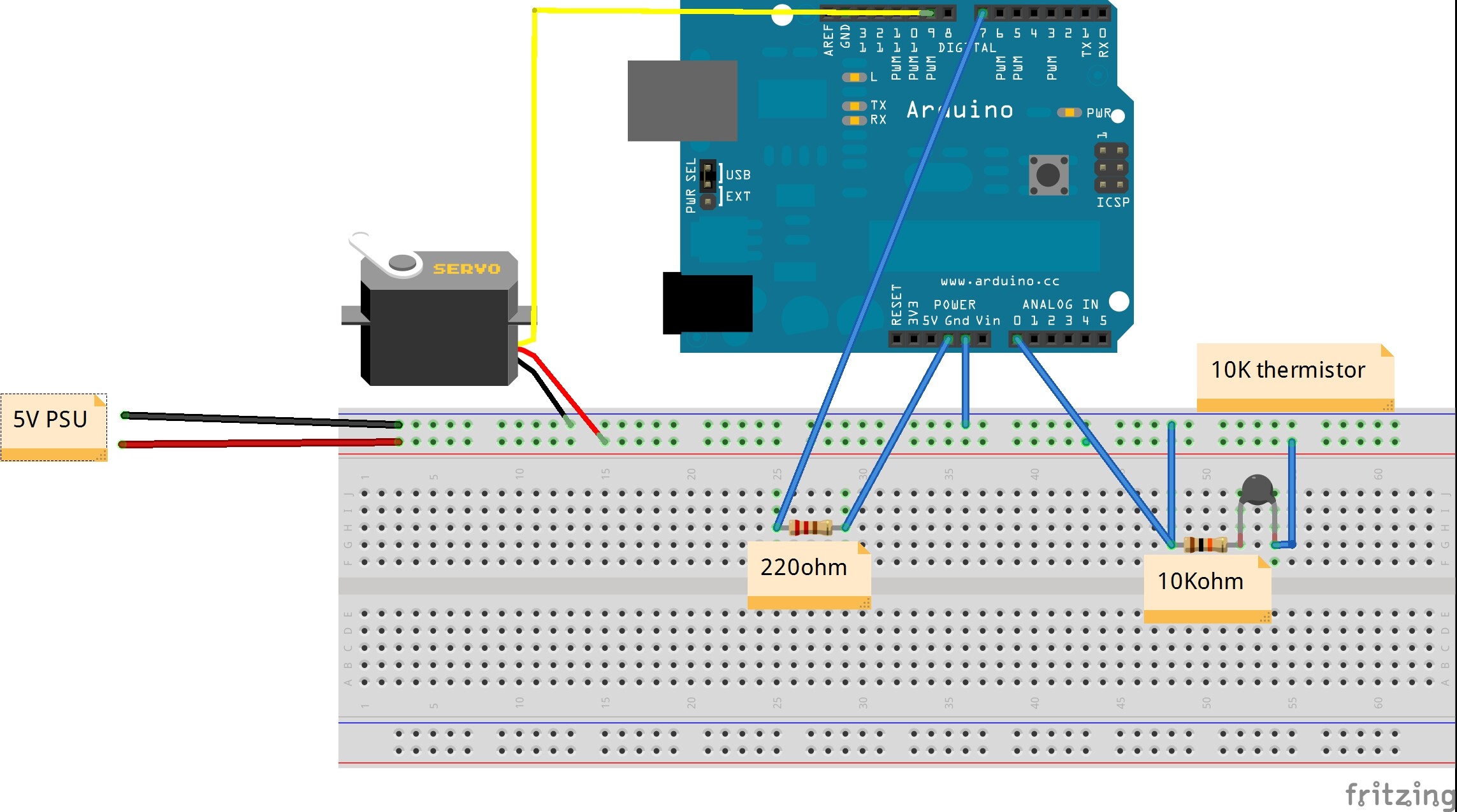

Here is my layout attached.
setting it to 90 helped, but it seems unresponsive to the thermistor. That or it's too sensitive. I used a VOM to check it, it's 10K.
Code is otherwise good to go. Well, after I add a capacitor inline to stop the bouncing.
Does my wiring look ok?
No.
Thermistor is wrong.

Could you elaborate please?
Given your lack of cooperation concerning the code tags you are asking a lot.
You have the analogue input connected directly to ground. You will therefore not read anything but zero.
Edit:- Ah I see you have decided to cooperate now. Thanks.
The analogue input should be connected to the junction of resistor and thermistor.
Grumpy_Mike:
I indeed DID fix the code tags.
The analog input is going from A0 to one side of Thermistor. The other side of Thermistor is going to +5v
Ugh I did my drawing wrong. oops.
The resistor side is going to A0 also running from the resistor to the ground.
I got it. Thanks Mike, it got me looking a bit deeper.

In that horrible Fritzing diagram that you've shown, the resistor from pin 7 to ground permanently holds that input low. (Most of us prefer conventional schematic diagrams over Fritzing diagrams. Your's is fairly simple and easy to read, but that's not always the case.)
Do you have a switch or something connected to pull that pin high as a trigger?
If you attach a pushbutton switch between pin 7 and +5V, the first line below will read the value on pin 7 and when you press the button the code between the braces will execute:-
trigger = digitalRead(CONTROL); // read input of pin CONTROL  and store it
 if (trigger == HIGH){     // reads if pin CONTROL, if true, do this:
   val = updateAvgtemp();    // read the value of the temp sensor (value with range of 1024)
   val = map(val, 350, 700, 80, 160);  // scale it to use it with the servo (value between 160 and 80)
   myservo.write(val);     // sets the servo position according to the scaled value
but as long as pin 7 is tied to ground, the above code will never be executed and instead this will happen, driving the servo fully CCW:-
else {
   myservo.write(180);     // sets servo position to 180 if above statement is false
Except I think you've now changed the 180 to 90, so the servo will be driven to it's centre position.
If you connect a wire to the point where the 220 ohm resistor connects to pin 7, then connect the other end of that wire to 5V, 'trigger' will read as HIGH and this will be executed:-
If you want it to work continuously, just connect pin 7 directly to +5V and remove that 220 ohm resistor that connects to ground.
I have no idea what's causing the 'bounce'. From what you've shown, it's an unrelated problem. At the moment, while pin 7 is held low, your servo should be fixed in one position. Makes me wonder if the Arduino is possibly constantly resetting. How do you power the Arduino?

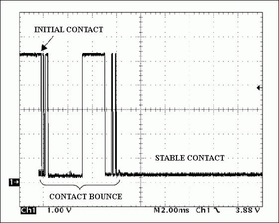

OK bouncing is the wrong word. In electronics when we talk of bouncing and debouncing it means the very rapid multiple contacts made when a switch makes or breaks.
Like this:-
What you have is the servo dithering or hunting. Most probably as a result of pin 7 floating and it driving the servo between two places. Your explanation of what you think that pin does is wrong based on your layout diagram, a schematic would have been so much better.
The other possibility is that as your temperature average routine is not very good it is producing unstable results. Simply read the sensor ten times, add them up and divide by ten. Do that each time you want a reading. Use the serial print to see if you are getting a steady reading from that. If they are not steady then your servo will not be steady.
