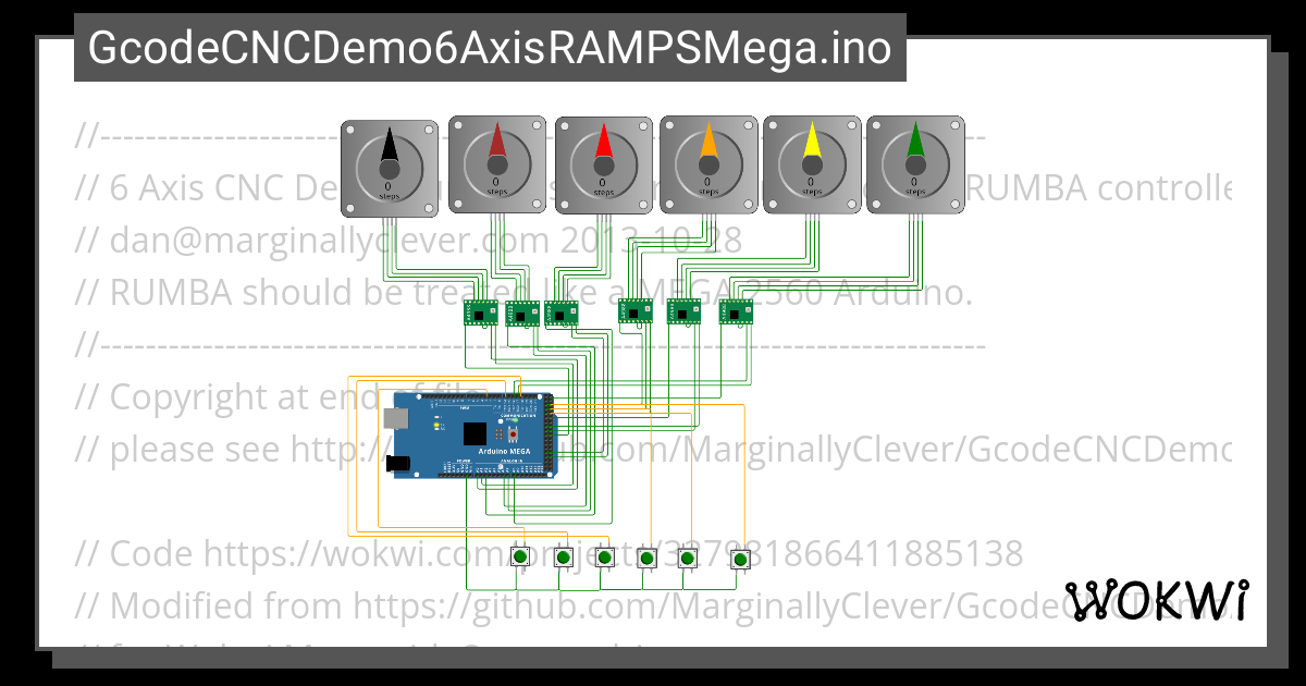

So I'm working on an Arduino project that uses a part I've never worked with- stepper motors. The goal is to turn three stepper motors attached to timing belts to open and close curtains when the Arduino receives a command. Unfortunately, I don't know how to drive and power the motors.
The parts I have so far:
  • 3 NEMA 17 42BYGH stepper motors (along with the cables, timing belts and timing belt wheels)
  • An Arduino Uno R3 (which I can change out if necessary)
  • 5 A4988 stepper drivers
  • A RAMPS board (someone on a discord server told me it was the optimal way to run motors from an Arduino, and I'm starting to doubt that)
    1. A12v power supply
Anyone have any tips for wiring this up? If possible, I'd like to power this all from the same supply, which probably means I need a little step-down board to power the Arduino off the motor power supply. Thanks for any and all help, and sorry if I don't know my terminology very well. I'm just starting with designing my own ideas instead of building stuff I found on the internet.

A RAMPS board isn't terrible -- but the tricky part is writing your own code for the pre-wired connections for the drivers and end switches. RAMPS 1.4 - RepRap could help:

Here's a configuration of some arduino code attached to a set of stepper motors attached to RAMPS pins:
RAMPS is generally ok. Wiring diagrams and more here RAMPS 1.4 - RepRap
The RAMPS board provides power for the Mega, so you don't need a separate 5V supply.
Are the steppers independent? If so you can use a library like AcccelStepper to move them.

I just realized something here, RAMPS was intended for Mega so a better board for Uno which does a similar job for 4 stepper motors is the CNC shield e.g. Arduino CNC Shield - GRBL – Premium Made In Europe
Not sure from your parts list whether you want 3 or 5 motors.
